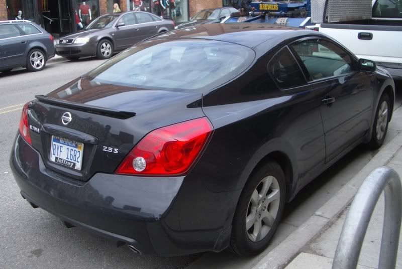

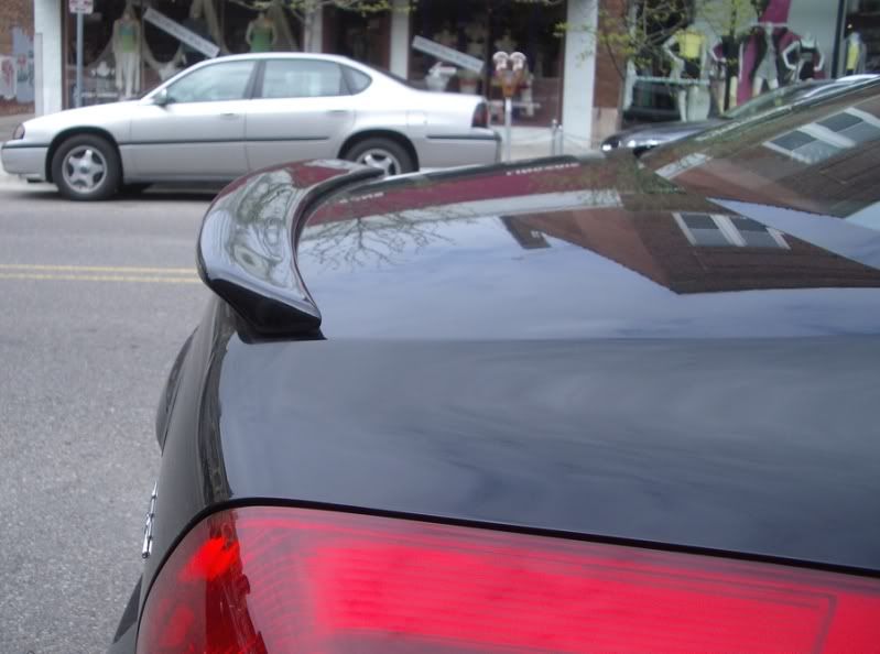

Thanks Tom, that kind of answers the spoilers I've seen on cars like the Mustang and Altima.
Pictures I've taken recently:

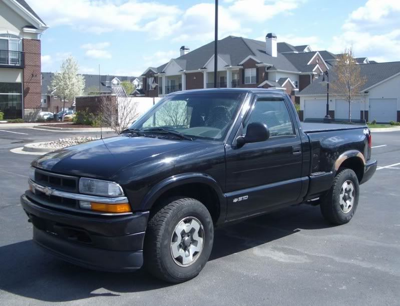

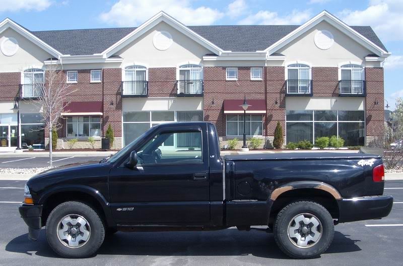

One memorable quote I took away from a terrible S-10 forum I tried posting at for a while was in response to the question of why members raised and lowered their trucks. The response was; because stock sucks.
I just did not fit in there.
To be honest, I don't even like lowered 911's.
I think this is because I grew up around rail road tracks in a industrial area. Most of the local cars within a few years suffered from broken rear leaf springs and drove around half dragging their butts. It's a memory of poverty I choose not to relive every time I look at my own car.
Raising the truck is just silly, it's already a truck raised above two wheel drive models., and just enough.

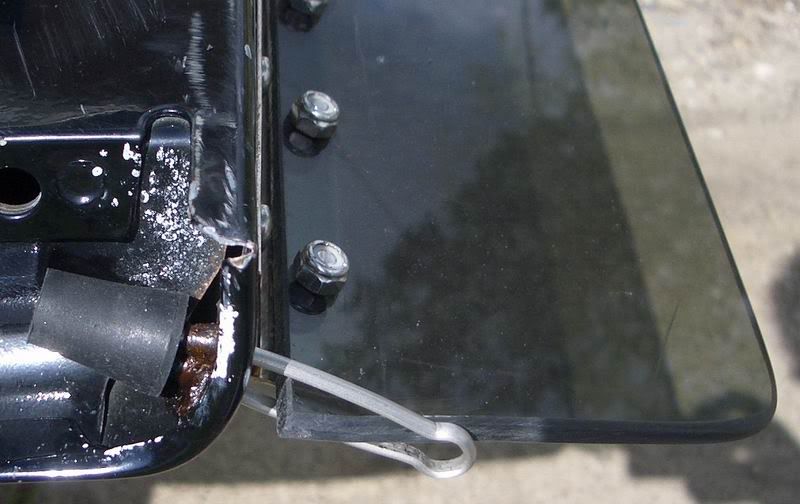

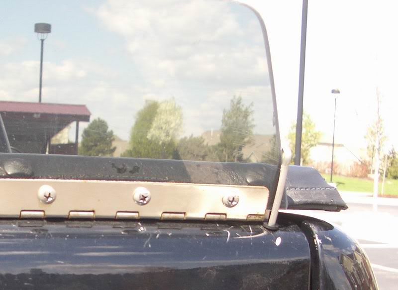

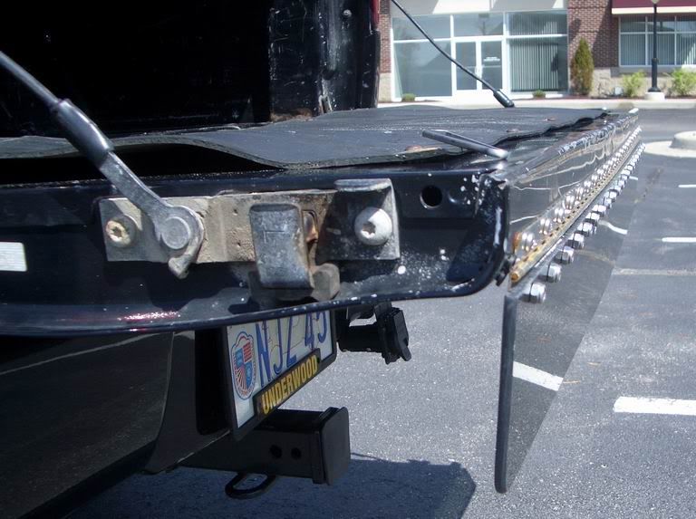

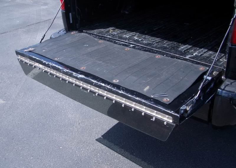

A cotter pin wiggled out and was lost, so I pulled the other one. I soon discovered this was a method for recording pressure/suction on the rear spoiler.
The rear spoiler is originally set near straight up, it takes less than one pound of pressure to get it to move, a couple of pounds to flatten it out all the way. Photos taken after max speed listed on picture.

I will be installing a rubber cork plug with a hole in it on the tail of the cotter pin to keep it from riding up again.
kach22i 05-09-2009 07:41 AM

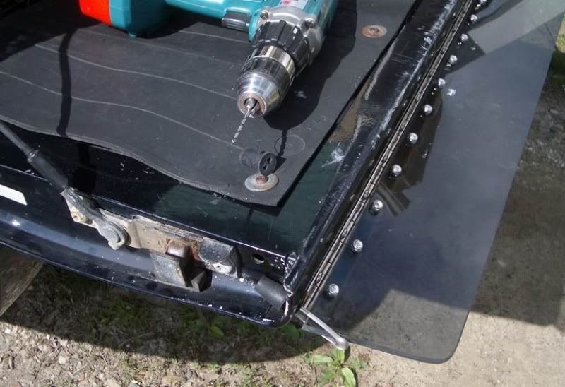

Posting pictures of the flip down spoiler and the rubber plugs I hope keep the cotter pins in place.

If anyone has an alternate idea, perhaps an improvement on the pin/plug arrangement, please feel free to speak up. I'm not 100% happy with it, something like a magnetic catch would be nice. Retractable and power stuff is out of my area of experience and budget.

I can set it at various angles, I think slightly upwards of 45 degrees is what I'm settling on.
