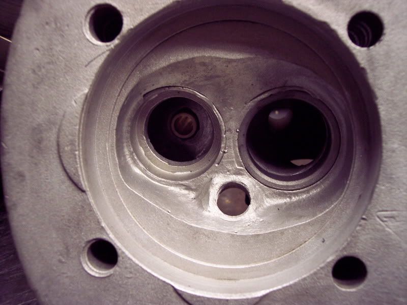

Well I got the case all together but ran into a problem with one head, it has a bad exhaust seat so now I have to order some next week and wait, wait, wait. I hate these heads, I prefer to rebuild the 911 heads but then that's what I am set up for. So in the meantime I am painting a bunch of tin to make it look real purdy.

Zeke 05-30-2010 05:12 PM
Intake seat lookin' kinda bad there.
cgarr 05-30-2010 05:23 PM
I think they mold the seats in place when they cast the heads. Now I know why they only get 60hp out of these things! The exhaust was so bad I could not even cut it clean but the others seem ok.
Joeaksa 05-30-2010 10:22 PM
Not real excited about either of them! Course this is not a high output engine but still, do the best you can and make it right.

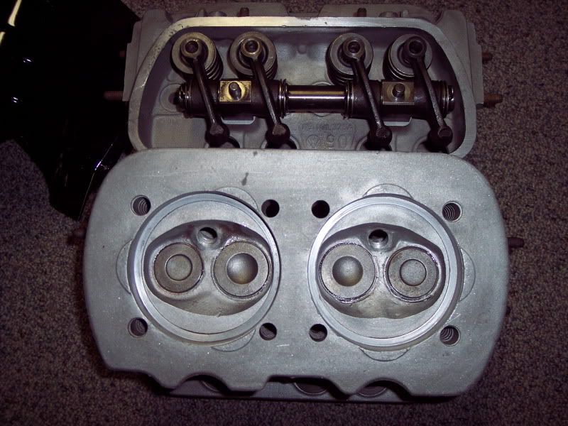

Got the heads done tonight, I was waiting for an exhaust seat that needed replacement, Don at Bug Patch shipped me one pdq. I put in all new guides, one new exhaust seat, valves and springs. Should have it back in the car this weekend!
