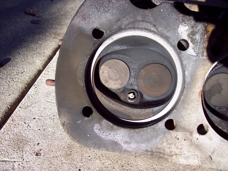

72 VW beetle engine rebuild
Well it finally puked. Leaking too much oil and no compression on one cylinder. I will post the rebuild progress here, its been about 30 years since I rebuilt one of these so this should be fun. One question, who is the best supplier for engine parts like gasket kits, big bore cylinder kits etc? I taint going to go crazy with this, I will keep it pretty much stock. The old time suppliers I have used in past were places like bugpatch and Clyde's buggies (CB)

Well I found the problem. I could almost spin #2 cylinder head nuts off by hand. Thats the easy part now I have to machine the case the same for all 4 cylinders and flycut the heads to match. Thats why it was popping and leaking a lot of oil.

For parts, as well as good tech info, try aircooled.net. Stay away from J.C. Whitney. It might be more cost effective to just replace the piston/cylinder set instead of machining the existing stuff. It's cheap insurance against future problems too. Same for the heads. If you flycut too deeply, you'll raise the compression ratio causing the motor to run hot and invite pre-ignition. It'll also alter the rocker arm geometry which can lead to damaged valve stems. You can compensate for this by shimming the rocker assys or shortening the push rods. If you're gonna open the case, don't be tempted to have the main bearing saddles line bored. This will ruin the case.
If you have a stumble off idle with that motor, replace the mechanical advance distributor with a stock vacuum advance unit. That'll cure it.

Got a little work done on the case. One head was loose and worked the cylinder into the case so it had to be machined flat again. I took off .020 and will use the same thickness base gasket for this one side. Next is to flycut and rebuild the heads. I ordered all the parts, it only came to about $450 with all new p&c's lifters, oil pump and all the other goodies.
