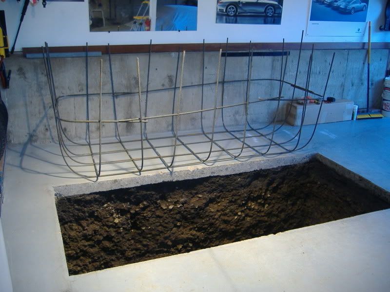

Looks like you anchored #4 rebar in your slab around the top of the pit. Did you just use a hammer drill to make the holes? Also looks like you don't have any rebar in your floor slab.

This job was a major PITA. From finding out that the rock under my garage was basically bedrock to trying to bend rebar by hand- it all sucked. But boy, oil changes will be a breeze now! Here is a pic of the rebar cage that is in the floor;
http://i125.photobucket.com/albums/p...it/05Rebar.jpg
I used a HilTi tool to drill into the floor, then epoxied the rebar into it- worked pretty well. As for the trackhoe into the wheel barrow- I had two wheel barrows going, and the trailer was only 10' away. Really didn't have any better option.

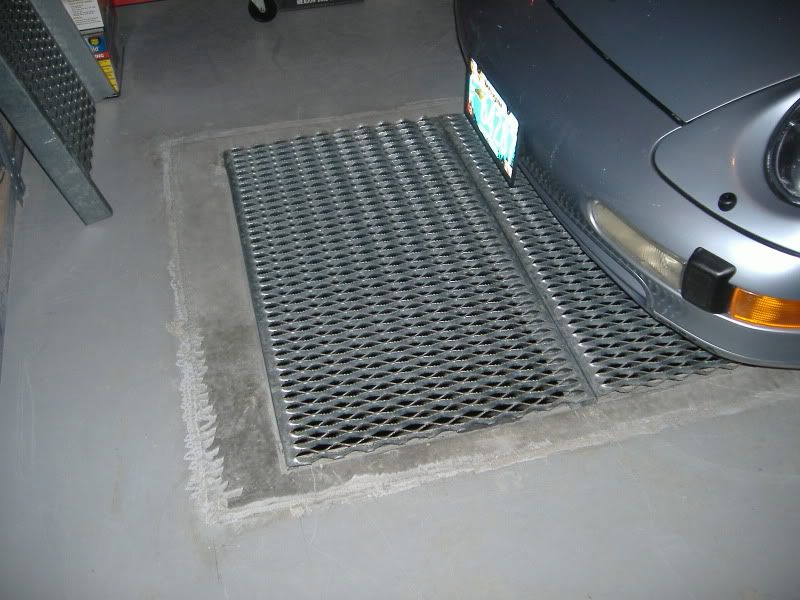

Changing the oil on the MCS is a PITA. Can't drive it up on the ramps, and even after I jacked up all 4 corners and put the wheels on ramps, I could barely fit my fat a$$ under there. Plus when you own a Land Rover, you need to be able to get under it pretty regularly...
Update: Found something to cover the hole up;
http://i125.photobucket.com/albums/p...overing001.jpg
I need to do some more work on it (the panels are a really tight fit) but I'm pretty happy with it. If it's dry enough this weekend, I'll paint it with that Rustoleum epoxy floor paint.

look 171 06-14-2010 10:03 PM

Very nice. I like the idea of the small sections to make them easy to lift and you only need to open what you need.
I would suggest you add some type of built in handles for each section to lift the sections.
I know you can have a separate tool for lift the sections, but permanently attached handles means that Kathryn will not be mad at you for losing them when you need for her to open the pit nor will she drop them on your head. :D

Trying to figure out how to do that. Unfortunately the panels are just too big for all 4 of them to fit, so I need to either make the hole bigger (tough) or make the panels smaller (easier but I don't want to weaken them).

For your narrow section, why not cut a plate of Aluminium and put a few pieces of channel on the back side to get the height right and add strength.
An alternative is to remove the excess material from the middle and use a channel or H beam to reattach the halves together. Notch the ends so the plate fits flush and provides some support for the break.

Handles could be simple loops of nylon webbing . . .

forget handles...get a hooked rod like the utility companies use for pulling up manhole covers. no sense bending over when you dont have to.
