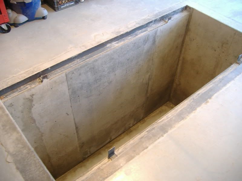

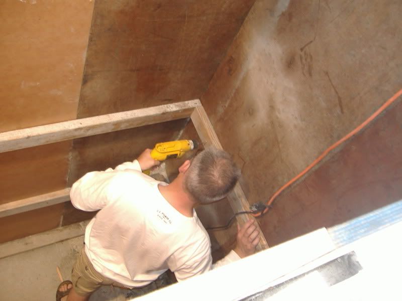

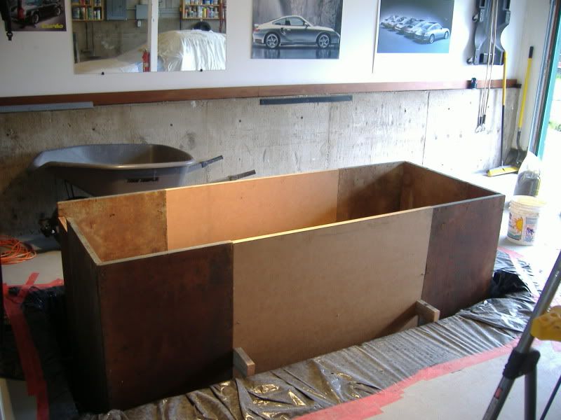

All:
I don't have enough ceiling clearance for a lift, so I just got done installing an inspection pit. Finished dimensions are 6' deep, 3' wide by 8' long. Offset toward the front of the garage so I can still slither in/out when the Discovery is over it.

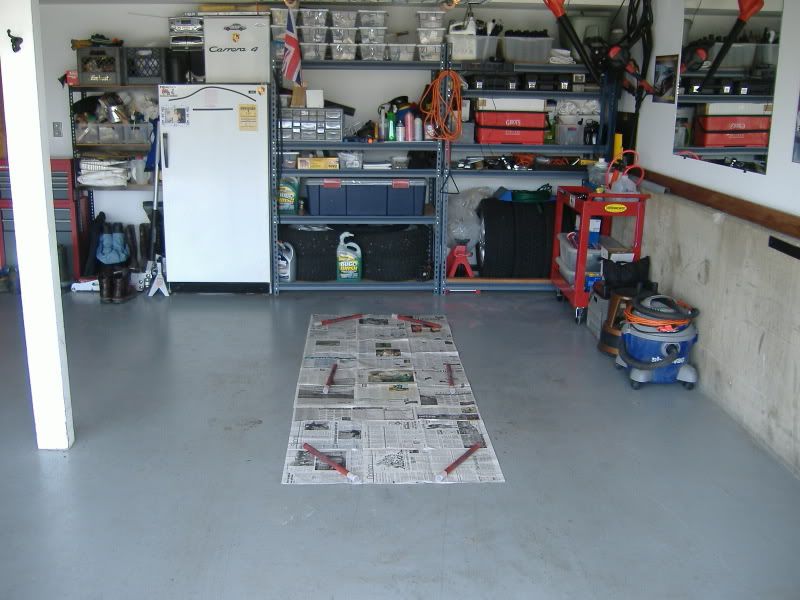

Step 1. Template:

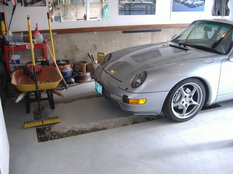

Step 2. Cut floor:
Step 3. Remove concrete:
Step 4. Excavate:

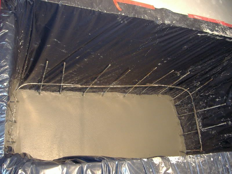

Step 5. Place floor:
Step 6. More rebar:

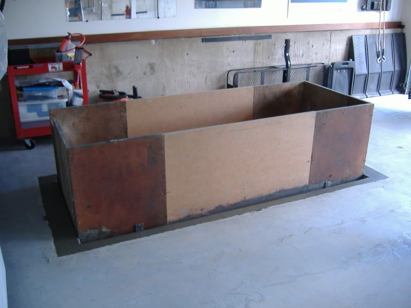

Step 7. Build form:
Step 8. Place walls:
Step 9. Strip forms:
Step 10: Finished! (Well, almost...)
Step 11. Timbers to cover hole when not in use (Still working on that- might use old aluminium walkways?) Next year I'll paint it with that epoxy stuff.

I would suggest your coat the pit as soon as the conrete is dry enough to accept the coating. Once you get oil/grease absorbed into the concrete, you will have paint adhesion problems and will need to take heroic means to get decent adhesion.
I also agree with the other poster that a small ladder may be nice as well.
One question, when the car is over the pit, how will you get in or out? I hope you will not be counting on Kathy to let you out, this could be dangerous

thanks for the responses! I am going to mount fold-out steps on the end wall. And I may well paint the whole thing this summer- garage floor is due anyway. Not in Pendleton- La Grande. The fan should work pretty well, but I'll keep my cell phone close. I took confined space training so I'm clued into that stuff. As I mentioned, I can get in/out when the Land Rover is over it, so there'll be plenty of room for getting in/out when the 993 is over it!

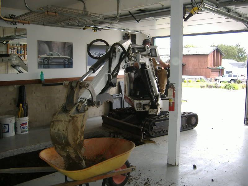

I guess you had to back up for each shovel full? Doesn't look like you had much swing in there...
Old 06-12-2010, 05:22 PM
Paul K's Avatar
Location: St. Thomas, USVI
Posts: 3,628
I started off by loading the trailer, but It was a real bear backing the trailer in then getting it out. I tried man-handling it at first, but loaded it was over 1,000# so I started doing it this way:

Great work - but one question I'd have based on your pictures is, you did check to see you have enough room to get in/out of the pit with the ENGINE END of the car over the pit and without the nose of the car hanging outside the garage door right?
The workmanship looks solid - one other thing Oregon is pretty wet and can have high water tables in places - any need for a sump or anything in the bottom of that?
Congrats if you got it all worked out - you definitely did a clean install. Be careful driving the car over that thing! Or better still leave the cover plate in place, then drive the car up and pull the plate out afterwards so there's no chance of getting a wheel where you don't want it.

That is a great pic - nothing like using a Bobcat load up a... wheelbarrow!
