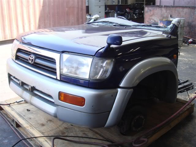

The "half-cut" I ordered from Japan. Its like getting all the goodies from a wrecked 911 instead of just buying a motor and then trying to figure out where everything goes. Surprisingly this little bugger fired right up on the pallet and ran like a champ!

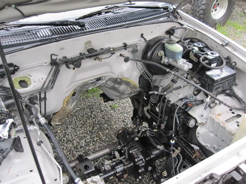

Next step was to remove the old V6 and prep the engine bay for the transplant. We had to reweld the transmission mounts as they were different on the diesel.

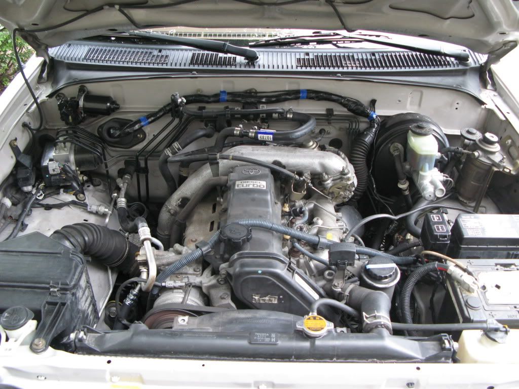

Then the transplant...
http://i172.photobucket.com/albums/w...E/IMG_1787.jpg
First impressions were....ABSOLUTELY AMAZING!!! The 3.0L diesel has gobs more torque than the old V6. The 5-speed transmission really helps to take advantage of all the torque...and makes it a lot more fun to drive. Oh, and the sound...WHOA!!! It sounds like a miniature semi truck, the diesel whine is addicting! ;)
So, more power, much more fun to drive and preliminary MPG tests show at least mid twenties which is a far cry from the 14 or so, I was getting with the V6.

After I sold the old motor, tranny and misc parts from the clip...the project cost me about $4000. I know that buys a lot of gasoline but that is not why I did it. The diesel/5-speed have transformed thus SUV from something that was boring to drive, into something that is as fun to drive as a 911! 4 grand seemed cheap for that type of reward.
Half cuts are usually between 4-6K shipped. Mine was on the upper end of that but the 5-speed brings a premium and the diesel only had 60K miles. I was definitely willing to pay more for low mileage which should bring me many trouble free miles.

If you get a front clip like that, you get to see how the motor sits, where the various wires and linkages go, intake and exhaust. Plus you get the mounts. Lot harder make a mount than to cut it off the clip.
Easy to do at the yard too, just cut it at the A pillar, strap it on a pallet.
