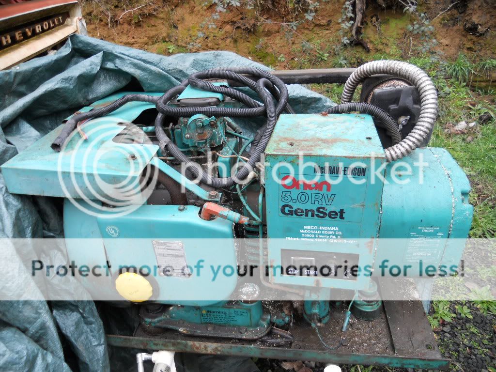

Question Free generator~ What do you guys think?
I'd have to drive 10 hours to get it and it has 600 hours on it.
Anybody know anything about this unit?

Looks like an early eighties model. Still worth decent money, but not sure it's worth a ten hour drive.

Think Onans are susposed to be good generators.

It's a Mcgraw-Edison Onan 5.0ORV GenSet. Says so right on it.

Good to have but I wouldn't drive 10 hours for it..that is round trip, right?. Is it 5kw?

You can find them for $200-400 in running condition

10 hours- ONE WAY!
I'm leaning toward a new Honeywell with Honda motor from Costco for $1000.

That is a 5KW generator. Its not a portable generator so I assume you want it for backup on your home? If so 5KW won't get you far. That RV generator is not worth a 1 hour drive...pass on this little gem.

I had a 7KW Onan Marquis Gold in my motorhome and that thing could burn through 20 gallons of fuel overnight if running both A/C units. A little Honda or Yamaha would be much more efficient per KW.

You're going to wind up pulling a permit to put a transfer switch on your house to use that thing...if you do it right. That's going to cost about $1500- $900 for the switch, and perhaps $250 for the permit, and $350 for the install.
OR...
You can just ask an electrician to install a 50 amp twist-lok 240 volt input next to your electrical service, and then buy a decent length of cable with a twist-lok end and then you can power your house. That's how I did it. It works for me because I have enough common sense to turn off my main breaker before I turn on the new aux power breaker that allows my 6.2 kw generator to power my house. Not to code, but it works!
You're looking at trouble with that generator; You have to figure out where to store it, where to plug it in, and that depends on what sort of output it has. I'd sell it on eBay and buy a Honda or Briggs & Stratton portable generator, which is made to be hooked to a home electrical system.

If I get the generator it will be mounted to the tongue of my enclosed race trailer in a weather tight box.
I need something to power my appliances at our occasional races or camping trips.
