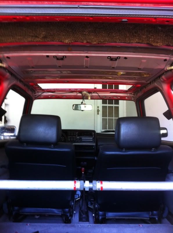

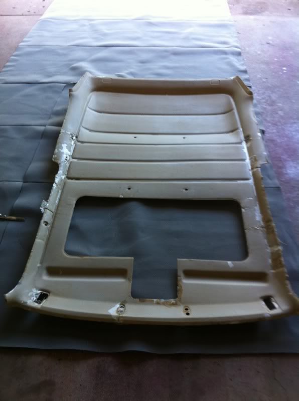

Got the headliner in, it was a lot of work but well worth it:

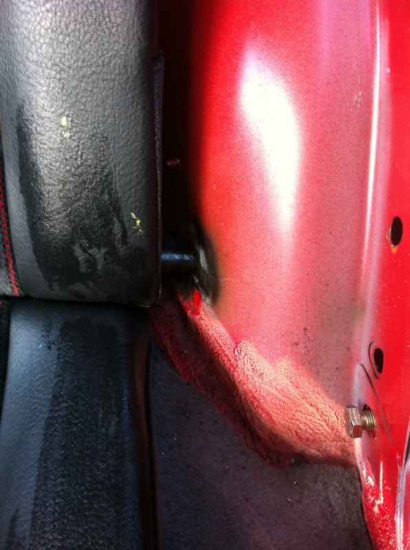

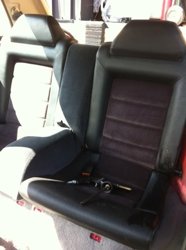

This car had Corrado seats in it but the rears were never mounted so I got them all installed correctly, tilt forward and lock, had to add a pivot support and extend the upright lock bar.

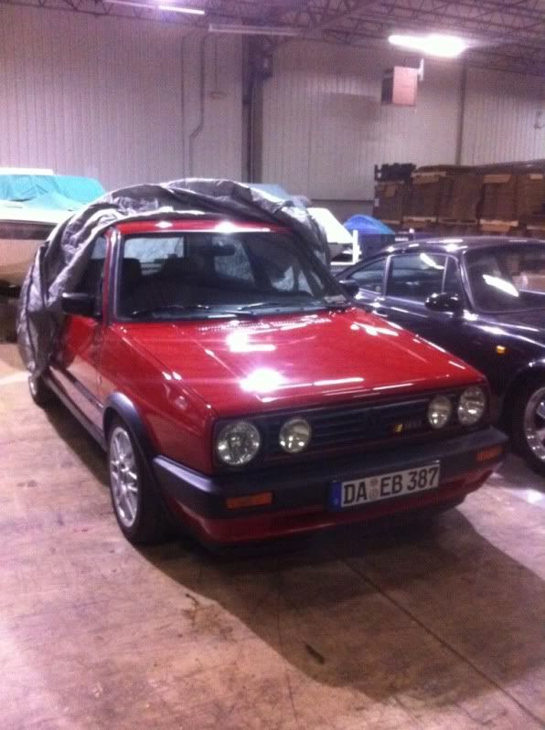

cgarr 11-26-2011 09:52 AM
Well its all done after about 6 months! I put it in storage until he gets back in January. I put about 4K miles on it this summer to really check things out which was good because it ended up needing a water pump at the last minute. Anyhow my next posting should be a video of him pulling back the cover to his "new" car!
