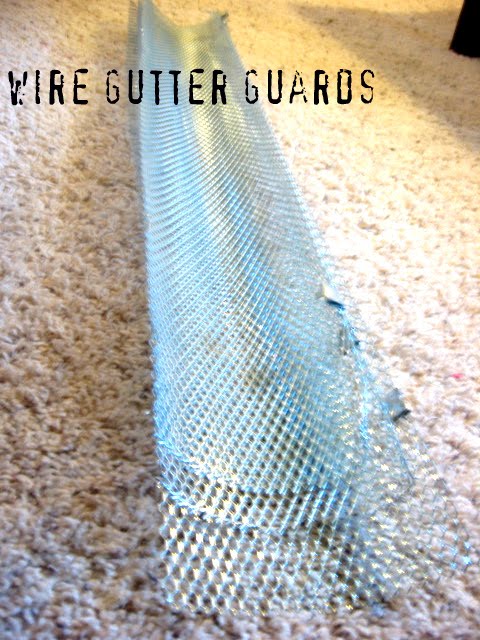

Wouldn't the screens that pop in do the same thing? There seem to be many, many variations. I like the idea of a cover over an open cell foam. I also just did a google image search for "gutter guard" and saw another option that I can't imagine would work as well, but may. It is essentially a large pipe cleaner that filles the gutters. I suppose the real benefit would be that pulling it out would probably pull most of the crud with it.

I installed black anodized aluminum mesh screens on the gutters 10 years ago. I check them every few years and they have been fine, ended the gutter cleaning chore.
We get serious leaf fall here in Ct so they are tested yearly.
They were inexpensive. I think I got them from egutter.
