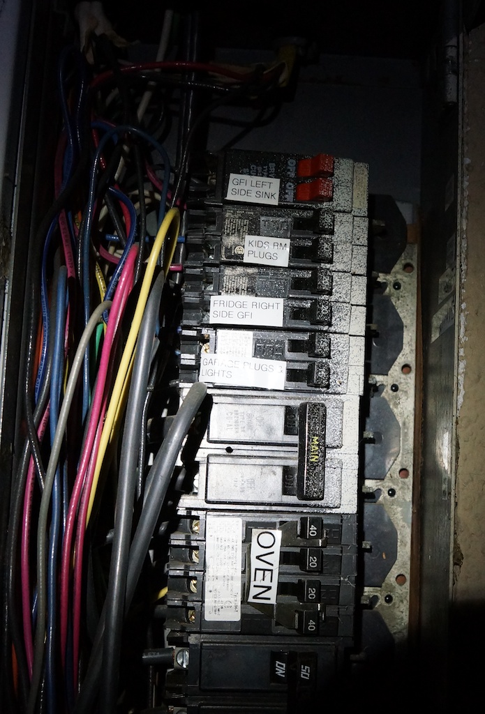

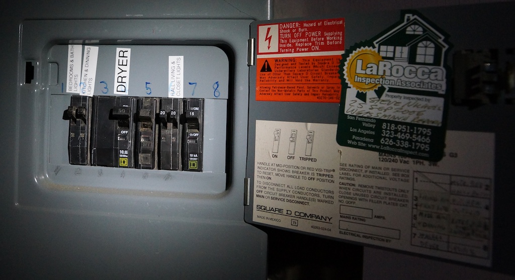

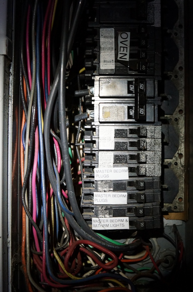

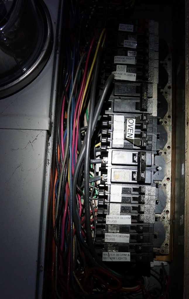

ok, for your sleuthing pleasure:
main board
secondary board
main-lower part
main-upper part

Those boxes need a hair cut.

Can't tell much from the photos because we can't see the main connections. I'd like to meet the guy that did that work. He shouldn't have a license, or probably doesn't have one. This is a pic of the panel I installed when I built my house. You don't have to touch anything to see where the wires run.

Yeah, I haven't done home electrical but I used to install cable and gawd knows I've set up my home studio and live gigs enough and have run miles of wiring. That install is embarrassing...and possibly dangerous. But again, I'm not an electrician so maybe that is SOP...
