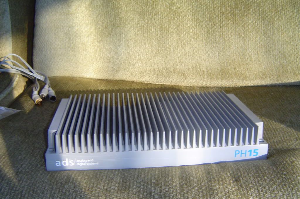

Is the A/D/S/ amp the PH-15?
Old 06-08-2014, 07:00 PM
Shaun @ Tru6's Avatar
Join Date: Dec 2001
Location: Cambridge, MA
Posts: 44,706
yes it is. any knowledge of it?

The 5th and 6th channels would be used to power subwoofers in a complete system, they might even be "bridgable" to run a single sub with double the power.
Rutager West
Old 06-08-2014, 07:14 PM
Join Date: Jun 2009
Location: St Paul MN
Posts: 5,427
Did a quick google search and the amp can be bridged
http://www.directeddealers.com/manuals/og/ads-mobile/ads_PH15.2_Owners_Manual.pdf
Rutager West

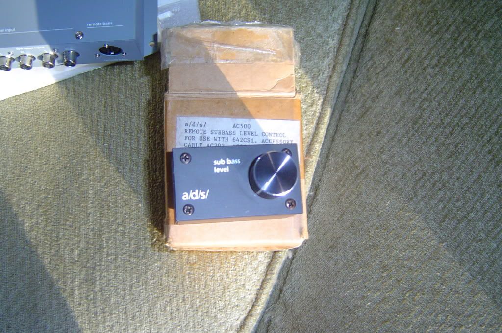

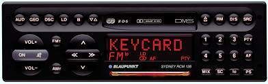

Yes, I upgraded the stock system in my e28 M5 a couple of years ago and used a NOS PH-15. I have the instructions/manual and I would be happy to scan it for you.
I wanted to keep it period correct so I went with a Blaupunkt Sydney head unit. An Ipod interface cable uses the CD Changer/Aux input plug.
Back speakers are a/d/s 345i and went in stock plastic housings.
Front speakers are MB Quart PSD 210 (these are old school ones that were made before RF bought MB Quart)
PH15
a/d/s 642CSi crossover/signal processor/interface adaptor
a/d/s AC500 remote bass level control
I put one these NOS Blaupunkt subwoofers (back when they were still made in West Germany) under each front seat. I know it's not ideal but I'm not a big thumpy bass guy.

That is one behemoth of an amp and might just be more than what you need for just the regular speakers.
I'm going to throw another idea out. That would be to just use the best pair of speakers in the front and get a 2 channel amp to power them. I think that rear speakers are a general waste especially in a noisy car like the targa. After all, when you go to a concert, you face the front, there isn't a band behind you too- now, a concert hall will have reflections that come from behind, but they are different then the original sound. Doing it this way will save a bunch of work and space, although you'll need to spring for another amp, but they aren't all that pricey for a good two channel.
