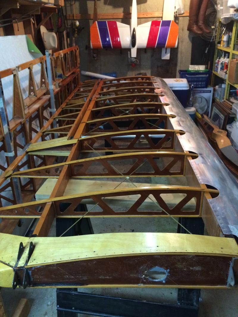

Just opened up the left lower wing, no critter damage, looks like the day I built it: Note the dark Resorcinol Glue that I used, this was the old powder and resin glue you cant get anymore, too bad cuz it was some great stuff:
http://i30.photobucket.com/albums/c3...psp6qfklma.jpg
http://i30.photobucket.com/albums/c3...pshztorjhr.jpg
http://i30.photobucket.com/albums/c3...psa3tupnpt.jpg
http://i30.photobucket.com/albums/c3...pshpcq2gts.jpg
http://i30.photobucket.com/albums/c3...psldxqxfvu.jpg
Tobra 12-03-2014 06:14 PM
That all looks pretty GD pristine. Resorcinol, interesting stuff, surprised it is not more toxic, with the benzene ring and all. Looks to be a pretty useful molecule. What can't we get from trees?
What was so great about the glue? An epoxy where one part is powder sounds pretty groovy, but there are a lot of good epoxies out there. If you don't have it, does it compromise the project?
cgarr 12-03-2014 06:27 PM
You have to remember this was back in 1985 and the epoxies did not have the track record I wanted at the time, the resorcinal went back decades in boat building, we will be using the epoxy now since you cannot get the old resorcinal glue with the resin anymore, only a water mix.
Tobra 12-03-2014 06:41 PM
They used to make a heat moldable acrylic in Germany called rohadur. It was a clear reddish plastic, the cat's ass for making orthotics, best stuff ever, easy to handle, heat mold numerous times and it would not get brittle, or really change at all. Had the perfect characteristics for an orthotic, firm, but not too hard, could be made thin so it would fit in your Ferragamo loafers, or whatever. They quit making it. Turns out the guys working in the factory where they made it were turning up with liver cancer. It was some sort of methyl methacrylate. If you have ever worked with it, you know is moderately nasty smelling stuff, and you don't want to get any on you. I have used it where I put the suction right over it while mixing it, the newer kits seal.
How did the old glue smell?
cgarr 12-03-2014 06:47 PM
What I remember it was not strong smelling, it was like a musty sweet smell, I remember it saying something about formaldehyde too?
cashflyer 12-03-2014 07:41 PM
Craig - you can still get the real resin/powder type resorcinol.
Look for Aerodux 185 if you really want it.
Personally, I like T-88.
cgarr 12-03-2014 07:43 PM
Yea T-88 is what we are using now.

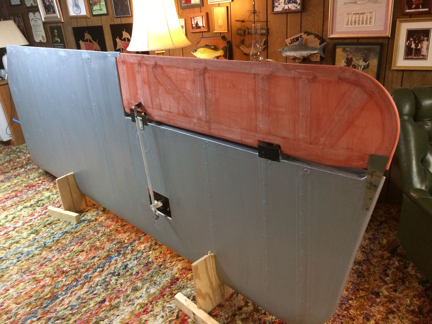

cgarr 01-26-2015 02:27 PM
We have both lower wing ailerons shortened up and now cutting into the top wings, need to make the spars, the lowers are ready to cover
http://tapatalk.imageshack.com/v2/15...7d6f7b94b0.jpg
You can see how long they used to be, the spar attached to the rear wing spar and filled in.

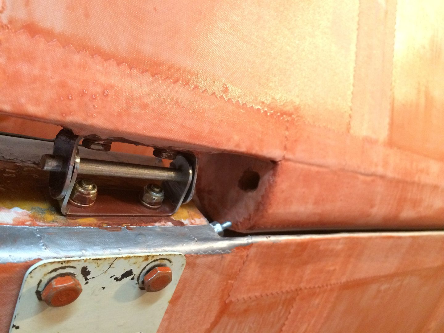

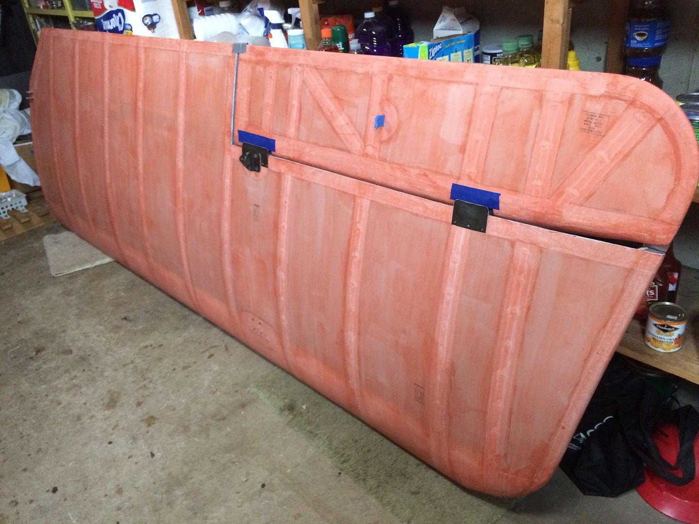

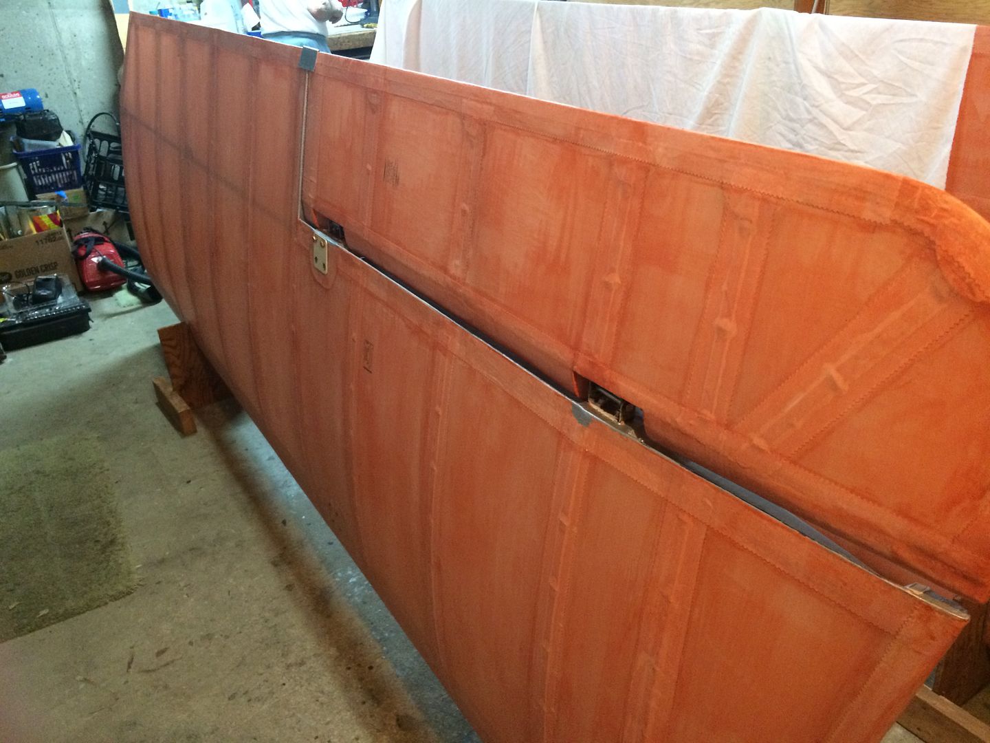

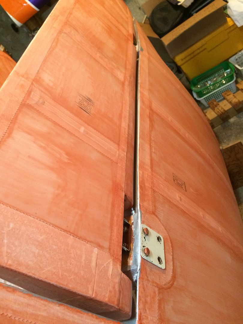

cgarr 01-02-2016 04:21 PM
Is been a very busy summer but got the wings covered and sealed. Shortened the lower ailerons and added them to the top wing. Cant wait to get it in color in the sprint and see how she handles with ailerons on both wings!

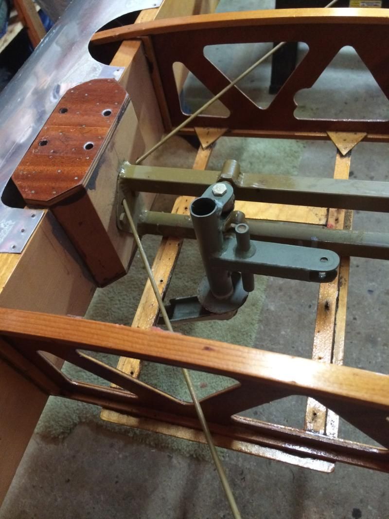

cgarr 05-26-2016 05:55 PM

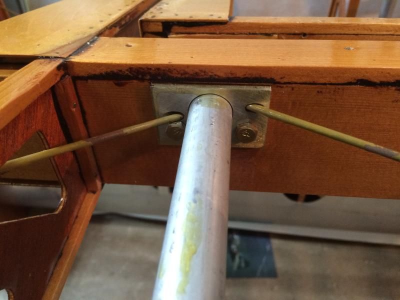

Working on one thing at a time, got all the controls hooked up and centered. The connecting rod I might streamline with some spruce I think would look nice
http://uploads.tapatalk-cdn.com/2016...e8bbb51b56.jpg
