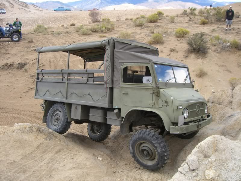

Although.... this one seems to be the same color as mine.
I wonder if the paint "chalks out" that badly, or if they were giving them a cheap spray before they came to the US ?
http://i42.photobucket.com/albums/e3...CIMG4701-1.jpg
widebody911 09-17-2015 11:36 AM
The color looked ok from here; is the color a "Swiss" thing?

cashflyer 09-17-2015 12:36 PM
I think it was just a "military" thing.
In person, you can tell that mine has been resprayed. Not only does the interior not match the exterior, but the exterior also shows where some scratches in the original paint were painted over with no sanding.
Originally, the military Unimogs (and Pinzgauers) would have been "NATO Green".
The RAL color code for this is supposedly 6014
RAL Color Chart | www.RALcolor.com
And the Fed-Std-595 color is supposedly 14050.
