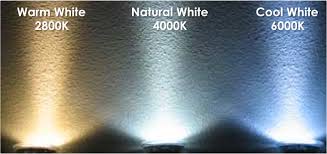

Regarding white (per your comment) typically you are selecting either warm white or cool white.
https://encrypted-tbn2.gstatic.com/i...YFFaqQtp3W6Qye
LED's are measured by temperature in Kelvins. The higher the temp. the bluer the shade of white. When you purchase your bulbs just check the temp rating or usually the package will tell you which white it is.
Regarding colors.....yes you can buy different colours but what I have found the best is to buy "color changing" bulbs so you can change things up if you want. Some of these color changing bulbs also have 'white' as an option so you only have to buy 1 bulb.

As Baz said you definitely want the 'warm' 2800K LED's

2700 K bulb LED are best (MR16 Halogen are still my favorite), very similar to the old fashion halogen bulb color.
