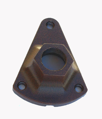

David - the Well Light is designed to be embedded into the ground so only the top of the housing is almost flush with the grade. Then you can drop the bulb down into the housing deep enough to block it from shinning in anyone's face but also angled toward the target to be lit up. (the bulb sits in a chassis that slides up and down inside the housing).
That said it doesn't sound like this type of light fixture is what you want.
If you are mounting above the ground then a directional light with an MR 16 bulb might work. You can get brackets to mount them with instead of the traditional stakes. (1/2 FPT)
Like this:
Tree Deck Mounting Bracket in Rust Finish for Landscape Lights | eBay
The other thought I had was going to a solar light that does not use any cable. But solar lights are not as nice as low voltage. IMO so there's a trade off off in illumination quality. I never use solar myself, BTW.
