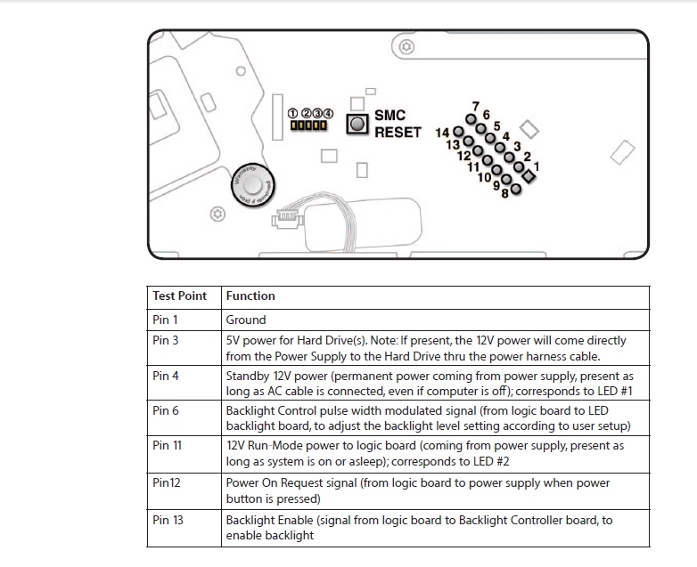

I yardsaled a 12.1 21.5'' imac mid 2011
at first try it posted an error screen with the hd not getting power
but then has refused to lite up at all
so I opened it up and tryed to check volts on the power suppy output
but finding a pin out for my exact model is not eazy [found same year 27'' pin out]
and I totally can't find a internal power supply diagram for this or any other imac
I find no 5v out at all [power for the hd]
and 11.87 v dc on the 12v lines is that near enough to work ?
and 3v on a line labeled pulse signal with no pulse just 3v steady
then checking ac input find the power button is not a 120vac switch
as power is always on to the PS 120ACV IN AND 12V [NEAR] OUT
SO HOW DOES A POWER BUTTON ''WORK'' ON A COMPUTER ?
being an apple all the parts are way over priced
a 205w ps is 150 new 100 rebuilt or 50 used
while a pc unit of the same power is 20 new
and I have no way to tell if the bad PS burned up anything else

And yes, there is always 12v at the power button.
Hitting it opens the circuit to the PSU which is why the slo blo is the first stop.
I would not worry so much about exact voltages that you are getting as long as you are getting readings the PSU is OK.
I generally recommend not opening those iMacs. They can be fiddly, especially the 21's.
Most common reasons they stop working is someone opened it to do a HD swap and broke a lead.
Really dead nuts easy to do on those things.
No power to HDD is usually someone borked the ribbon cable.

I get no 5v power right at the power supply pins
while getting 3.0 and 11.87 on the pins at the p/s
also tryed to check at the m/b power in and got power there also
but apple split the m/b power into two connectors and I have no chart or idea what pin # at the M/B unlike the 27 that has one power connector into the M/B
I think the link shows the 27'' not my 21.5 pin out at the M/B but the numbers match the 3v and 12v pins at the power supply of my 21.5 unit while the 27 power is in one block in at the M/B connector
27'' link https://d3nevzfk7ii3be.cloudfront.net/igi/moS64VEIPaD6QDkR
can you confirm that is the M/B pin out ? and if it the same as the P/S
as I am basing my hunt on two assumptions one the 27 and 21.5 P/S is the same for pin # volts
and the 27 M/B pin# are the same as the 21.5 at the P/S
that looks to be correct based on the volts at the P/S except for the missing 5v
apple appears to use a common ground for all volts to the #1 pin and no neg 12 or 5 v lines
that PC power supplys have
don't really need pic of the apple as the PDF has a lot just no diagrams of the pin# or schematic
of the M/B or P/S guts
a pic of the suspected ''fuse'' would help and where to get a replacement

found this bit on an other mac board
''There are quite a few things that can be wrong for a board not to boot. You know you have 3.4V on G3Hot so that is a good start. I would next check to make sure the 3.3V supply is putting out 3.3V. It is a dual port device with the other half putting out 5V but 5V is not enabled until later in the power up sequence.''
now that brings my 3.0x v reading on pin#6 that should be 3.3v in to question
but what I do not know is if it powers up later like the 5v bit looks to do
of course if I am reading it right and IF he is correct about the 5 v power up sequence

does apple really use one ground pin for all volts 3.3 5 and 12 v pin #1 on my power supply
and no negative 3.3v or 5v at all ?
what would happen if I used a PC p/s to feed 3.3 5 and 12v on the apple imac
as I have several from older PC's so a no cost test if it will not damage the imac
how to wire the separate grounds on the PC p/s to the apple imac ?
is a PC start switch the same as the imac ''power button'' ? the front push button not the a/c switch on the actual p/s box
will the imac signal start a PC P/S ? or is apple different just to be apple different ?
is the 3.3v line apple calls signal send a code or just voltage back to the power supple at start button push ?

and if you know how to power it up outside the box to test
or if it can even do that with out being hooked up to the m/b
also how to check the pc unit ps outside
and how to wire the apples common ground for all voltages to one pin #1
if I can adapt the pc unit I have to powerup/check out the imac

OK, the two black leads are the main hot and ground. Ground is the bottom, hot the top.
If the iMac is plugged into power you should always get 12V there whether it's on or off.
When not powered on you should not get any readings at the molex connector at top of PSU or anywhere else inside the case.
The fuse is the black cylinder just above the hot lead.
I doubt it's bad as you are getting readings past the main hot. If it were blown you would get nothing out of the PSU when powered on.
Look to the right of the RAM slots. There are 4 diagnostic LEDS. How and when they light up can help you determine where the problem may be.
Check the Technicians PDF I posted for the sequence.
As far as testing the PSU out of the case you don't really need to, just disconnect the molex at top of PSU and it will be isolated from the rest of the components. Check for readings at the connector.

thanks for the pictures
guess my fuse/link is good as it gets 12 and 3 volts out but no 5v at all
does the 5v line power anything other then the HD and dvd drive ?
but only one led lite is lit #1 and apple hid them under a cable
so not only does the screen need to be off you need to lift the ribbon cable to see them
