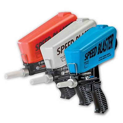

Hey everyone.....thought I'd post a brief update on my blaster thread.
I have a buddy who worked at the cape for many years (rocketland as they call it ) and he has a fair amount of experience doing body work and such. He had this little metal blaster can that I borrowed just to try out and it really worked good - for small applications, which is what I have a lot of.
Here's what his can looks like...it's disassembled in the pic, obviously but you get the idea.
So I think I will order one of these from Amazon because the reviews are pretty good. Will keep the thread posted.
Couple other details....I used white sand from a bag that is used to top dress pavers and poured it into several containers and left it in the sun to fully dry out before using. That made all the difference in the world. Also, I ended up buying a used power washer from CL to do my steps and it basically did the job I needed.

You guys are doing better than me. I bought one that looks like Baz's blue one in the pic. It is useless.
I visualized using it for small spots of rust and getting a really clean fresh surface. It doesn't seem to have the mojo, but if I fire it at my hand even a foot away I can feel it sure is working. Just too mild I suspect.
I also thought it would be good for cleaning up welds before painting but I don't think it would manage this either.
I have one , and like it for what it is. Quick and dirty for little spots, and maybe a quick blast before welding. I run 165 psi line pressure . Maybe it helps. also, the size media you use will make a big difference.. The finer stuff, while less aggressive, seems to flow through the smaller nozzles easier .
I also have been using a modified HF pressure pot, with a better hose, and nozzle set up. Works pretty good for what it is .

Thanks. I don't think I had my psi high enough. I'd been using the fine grade garnet but may do the bake it absolutely dry thing too.
