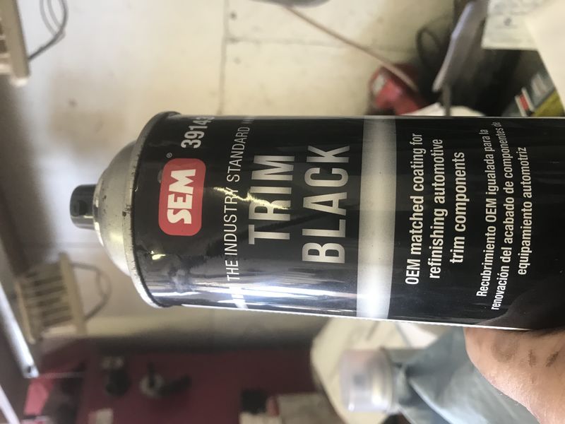

SEM Trim Black.
Matte black.
Clean, scuff and spray.
It will last years. Rustoleum won't. (I have never used the plastic spray from rustoleum - referring to their standard paint in a spray can.)
