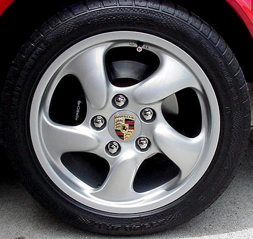

Hey Guys,
Although all my Porsche buddy's think Im the concour weenie, I can honestly say I just used my first Q- tip last weekend. I would not have gotten them out if I could have gotten my finger in there... Yes I like a clean car, why drive Porsche all dirty..its just wrong...haha
I have been working on bring this C2 back from an abused past life. The paint less dent guy worked on her for 2 days to get all the door dings and parking lot creases out.
I have clay bar'ed the car and only use Zymol's Special Red Wax, but I still have minor scratches in the paint. I don't want to take the buffer to it.
What product have you guys used with success ?
Check out the New No Turn hub caps...Yeah a little on the gucci side, but I like them.
thanks,
Don

i used the 3m imp hand glaze and was happy on a black car. i also have a red C2 and will be detailing her this weekend. i'll report my results with the glaze on the red.
"no turn" hubcaps...you may get points taken off for not aligning the bottom of the crest to your valve stem.
