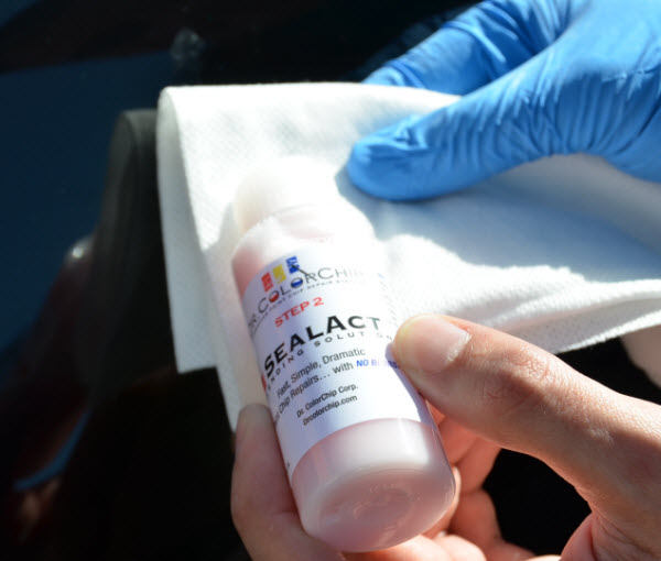

After allowing the paint to dry for a few minutes, it was time to remove the excess using the SealAct blending agent. Have to admit, it's initially nerve-racking to stand and watch paint dry on your car but it all works out in the end! Using the supplied blending cloth with even pressure, we removed the excess paint and this part you just get a feel for - some spots require slightly more pressure than others - but still, we're talking light pressure:

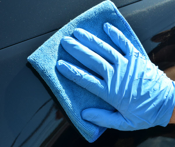

Finally, it's time to buff out the area with the supplied microfiber towel. Buff clean and take a look at your work. We were impressed with the results and believe an even better result might be attainable using Dr. ColorChip's Squeegee:
