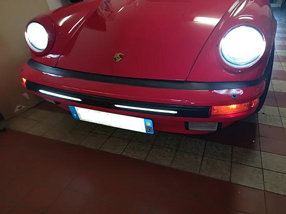

and yes, do not forget to install the relays into the system...or get your self LED H4 light bulbs .I just got them and replaced them last weekend 80 euros.

It looks like this after;-)
