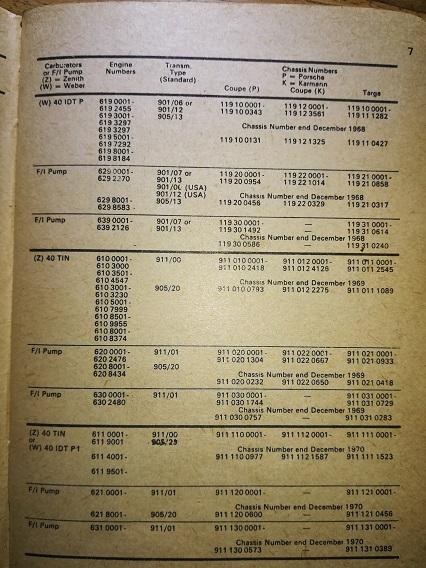

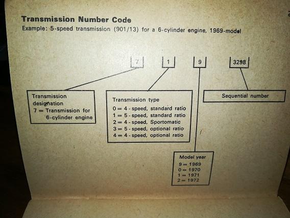

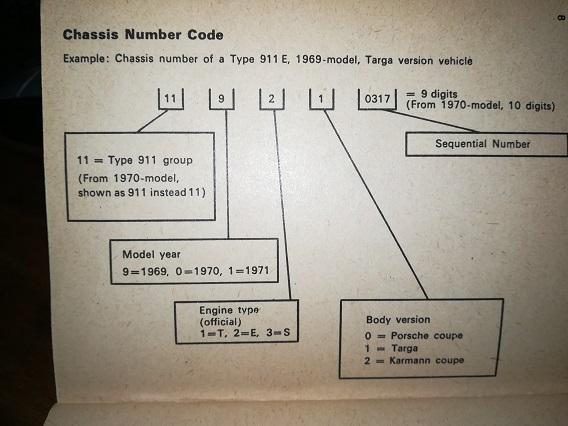

Does my engine # match
Hello, some members apparently have books that help in this regard so I’m asking for assistance before reaching out to Porsche for confirmation. And thank you in advance!
Details
1969T
Chassis #119121021
Engine #6195572
001/16
19259
Transmission. #7104399
901/13
Thanks so much!
Jay B.

here are some informations for you........
[IMG][/IMG]

all you need is above, to verify ...

Seriously, you've been given all the source information available outside of Porsche itself. If you are unaware, the only way to know if your numbers are matching is to contact Porsche directly. The best anyone outside can offer is what you've been given and that will result in a confirmation whether or not your engine falls within the range of engines assigned to your chassis.
