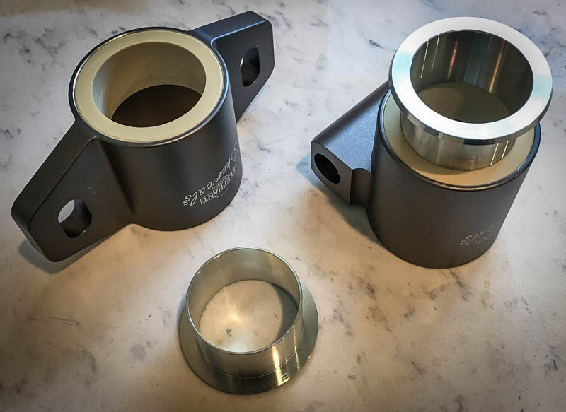

It seems that the main difference is that the Sphericals will maintain low stiction even when the chassis is loaded and flexing, whereas the RSR bushings might not.
To me, the primary benefit of either over rubber would be an improvement in ride quality (due to the lower "spring" rate of no twisting bushing) with a minor increase in noise/vibration in the cabin (which is subjective).
Anyone have experience with these? I've read a bunch of threads on them both, but it seems like a lot of posters confuse them with polybronze or some kind of hard-compound solid bushing (polyurethane, Delrin, etc). It's also very rare to find someone who installs them without also changing spring rate or some other component that has a large effect on the system (such as monoball shock tower mounts or shocks themselves), which makes the anecdotes difficult to judge.

The Elephant Sphericals rotate on two axis.

Well, I wound up going with the Sphericals. The yellow compound that forms the inner "bearing" doesn't seem to move at all by hand, but...as long as they work on the car.

I'm about to fit a set of Sphericals on my SC and the inner metallic race seems to be stuck to the whitish spherical bit. Has anyone had this issue?
As far as I can remember, when I purchased the Sphericals a few months ago the inner race could easily be removed by hand...

How much does your chassis really flex?
How much does your chassis really flex? Not some bench video. Any comparative skid pad data or course data?
I prefer to keep my pivot shaft on the design axis. Stiction is from rubber bushings. These cars were not built "perfectly" square decades ago. Rebel has spherical washer kits if a simple flat does not get shaft install perfectly free. This car had to use NO simple flat washers. We had a car with a professionally done front clip that had to use some washers. Cudos to the body shop that did the repair.
Maximizing plastic bearing material in contact with shaft is important. I have actually designed plastic bearings. I have Rebel RSR bushings front & rear. Make yourself happy; it's your money.
Properly aligning/bushing mounting surfaces is too difficult? Plastic bearings are all about PLI (Pounds per Linear Inch) so I went with Rebel. Are you too lazy to do it right??

The advantage of a spherical bearing over a linear bearing is that the bearing alignment axis can shift slightly and not bind while traveling through its normal range of motion.
Not sure, but the colored surface could be a coated PTFE dry lube/friction material. Can anyone confirm?
