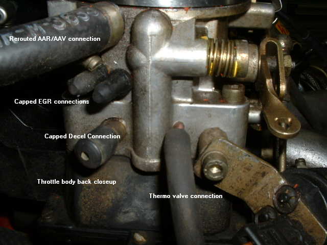

Old 03-12-2003, 04:58 PM
Original Owner
tsuter's Avatar
Join Date: Dec 2002
Location: San Antonio, Texas
Posts: 1,907
EGR Exhaust Gas Recirculation . Two small nipples on the back of the Throttle body with air lines attached.
Earlier you said that your repairs may have fixed several small air leaks. Possibly the CO was high before to compensate for the leaks. Now there is less of an air leak (AAR would still be behaving same as before) and the CO is now too high. High CO will cause a faster idle up to a point. As Jdub said if the air connections all seem fine then you should check the CO to verify it when the car is fully warmed up.
I know duct tape is useful but I would be using real vacuum plugs on those lines also.
Here is a picture of the back of my 78SC throttle body with most of the lines. Mine is not stock so many are capped off.
There is a whole thread on how to check your AAR. It closes by motor heat and by a 12V internal heater. Somtimes it can stick open which possibly yours is doing.
