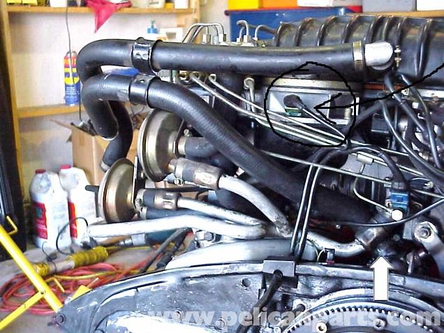

jj..have you ever tried to unplug the bosh connector behind the sensor plate.It is a safety device ,it will cut the fuel pump off if it is kaput -broken grounded..simulating car is on the roof....
this one
Ivan

for the future if have a problem and do all the checking on relays ..check this plug first;-)
THIS....
I believe the main observation is this:
With the air-filter cover off and ignition on, lifting the air-meter arm does NOT cause the fuel pump to come on."
If you would have disconnect the plug the fuel pump will run with the key on...
Ivan
