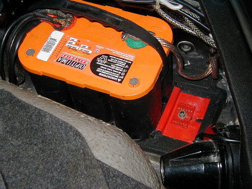

Hopefully the battery you bought has a lip along the bottom of each end. If not, I'd suggest taking it back and swapping for an orange-top. You will need a longer ground strap...go for a 1 or 2 guage strap. Use the inner threaded hole for your clamp. I picked up an adjustable aftermarket clamp at the auto part store that works perfect.

Mike, the red top I got does not have a lip on each end like the oem had. it was the only style PEP boys had. didn't know there was an orange top. I may have to go elsewhere. The inner threaded hole you mentioned, is that towards the front of the car, where the front end of the battery sits? If so, I think my hold down rod was broken off at the base and will need to be drilled out. There was no hold down when I pulled the old battery out. I was now thinking instead of a longer strap, buying a cut off switch, as it should extend far enough to reach the existing strap, and the car will tends to sit for a week or two at times. Gotta stop the corrosion first before doing anything.

Mike, Your Optima install looks clean and is how I would have expected it to look. I went w/ the OEM, man what a PITA to install. Only thing it has a vent port and I installed a tube and catch bottle to keep water/acid from going all over the place.
