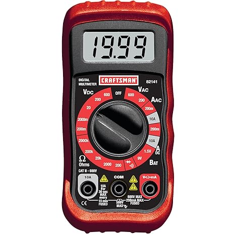

Never quite understood voltage drop.
When I measure battery voltage, am I measuring voltage drop?
I put the dial on VDC 20 (exactly as in photo)
And then touch the leads to each battery post.
When I get a reading of 14V, is this voltage or voltage drop?
https://images-na.ssl-images-amazon....uL._SX466_.jpg

Voltage and voltage drop are the same thing. With the multimeter you basically measure voltage from one point to another. With charging systems and batteries one usually measures voltage from chassis to battery positive or D+, DF, D- on the alternator to chassis.
