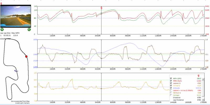

Here's a stock '78SC except for a 7:31 cwp, not a very useful setup
Just for a perspective here's alap at WGI , 3,4 & 5 are used, speeds generally 80 to 120+/-
915 w/ 7:31 would be in 5th 98% of the time
Bill Verburg
