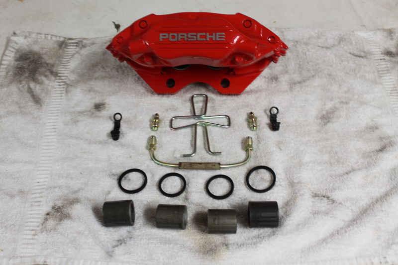

Been a long time since I first posted my ideas. I now have everything in house and have been getting everything installed on the car. The amount of time I have into this is way more than I ever would have expected. The caliper refresh was a good chunk of it. This includes the time to grind the caliper throats to accept the 28mm turbo rotors. Not difficult to do with a 6" cutoff wheel in a high-speed angle grinder. Cleaning everything as it comes off the car is another big time sink. All hopefully worth it in the end.
The rears first. We know this has can be done using standard 930 turbo rotors as it has been documented previously.
Calipers disassembled and professionally Cerakoted with the high temp coating. I purchased the rear calipers with the mounting holes already relocated. Someone did a nice job plugging the original holes and re-drilling on 3" centers. Unfortunately they were done for a standard Carerra rear rotor and 1/8" to far inward and the caliper would not clear the larger 930 rotor outer diameter. I took them to my local machine shop and had the holes moved outward and everything lines up perfectly (see the photo a few posts down, you can see there is plenty of clearance and no pad overhang.

In order to get the caliper centered on the rotor, the caliper needs to be moved inward almost exactly .125". Rather than use a bunch of washers/spacers I fabricated an aluminum piece from some 1/8" aluminum stock which put the rotor in the center of the caliper.
http://forums.pelicanparts.com/uploa...1595908948.JPG

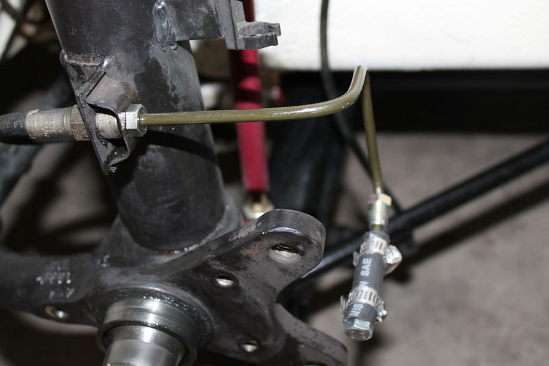

Few other details, the front dust shields need to be modified to fit the larger calipers. (On the rears I just left them off completely).
http://forums.pelicanparts.com/uploa...1596996404.JPG
Custom hard brake lines, 10" Choline parts from Bel-Metric:
