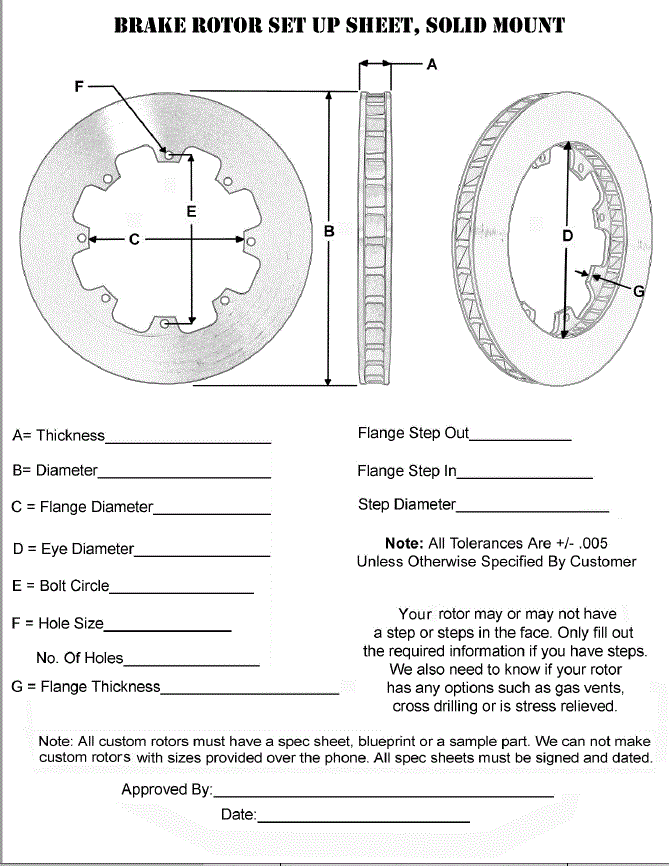

Here are the specs I have for the rotor and hat. These are updated slightly from what I built as I had one small error, the bolt circle was a bit too small and I had some interference between the bolt heads and the hub on five of the bolts. I had to grind the bolt heads flat and enlarge those 5 holes slightly to get the bolts to drop in. This version should have enough clearance there and the hat is .25" larger, so .125" bigger radius which will give enough clearance for the bolts but still clear the caliper and pads.
The dimensions are all on the rotor sheet to fill in the Coleman PDF custom rotor spec. sheet, but I would encourage everyone to double check my dimensions :-)
Flo, you can see here that the rotor diameter is 285mm (11.2") which is just slightly larger than the 282mm Carrera/SC rotor. I wanted to make sure there was no pad overhang and be able to move the caliper a bit more outward axially to clear the rotor hats on the inside. Coleman Racing made the rotors, Mittler Brothers made my hats. If I were to have hats made again I'd have my local guy (Jay of Jay's machine shop here in San Jose) make them, he quoted me $75 each which is a great price. Mittler Brothers were great though, easy to work with and relatively quick for a one-off very small job.

This sheet still calls out a 0.25" thick hat, as mentioned above I would probably go with a .3125" (5/16) thickness, readily available stock and move the rotor inward so the caliper can also be moved in away from the wheel spokes without having to add wheel spacers.

Here is the Coleman rotor setup sheet. The above post has all of the proper dimensions. They have several different rotor blanks to use as starting point, can all be found on their web site.

Did the custom rotor hat come from Coleman or did you make it? Any chance that you have a Stp file?
Thanks
wjdunham 08-14-2020 03:59 PM
I had a company called Mittler Brother's make them for me. They have a similar product but different bolt hole locations etc..., so I just gave them a call and they were happy to machine them for me. Any local machine shop should be able to knock them out in a couple of hours.
And no, sorry, I don't have any cad files, just Powerpoint from which I exported the attached GIF.

My designer drew these up for me using Bill's diagram.
I asked my water jet guy to make me 2 at .25 and 2 at .3125.
So I have two extras if someone is interested in them send me a PM.
To clarify these are $100 shipped (CUSA)

I'm going to tweek the design and recommend M6 fasteners around the perimeter. My reason is two fold;
packaging is very tight and the m8 is overkill. The 5 M8 bolts used to attach the adapter to the hub collectively generate 82 Kn of clamp load. The 10 M6 bolts that I'm suggesting can collectively generate 90 Kn of clamp load. Furthermore I'm pretty sure that the original design also uses M6. Coleman can make the holes smaller.
