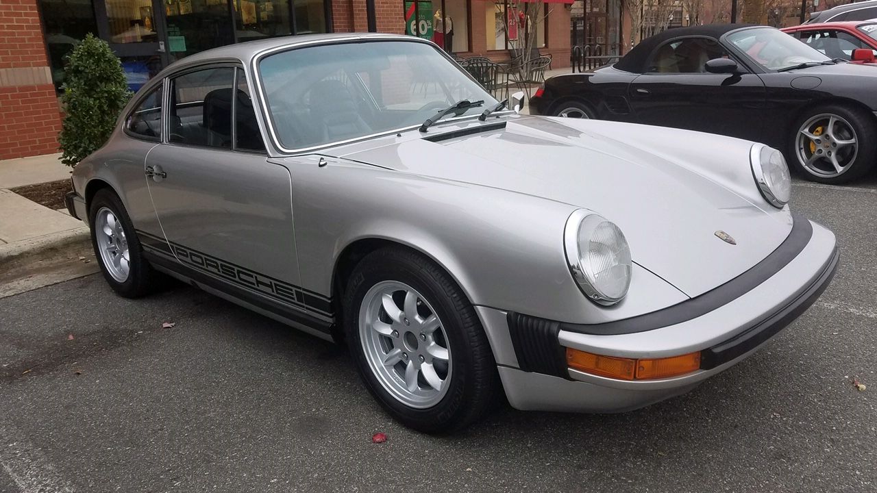

Quick question for the many informed enthusiasts here... I am the current caretaker/ owner of a 912E with 3.0/ 915 conversion from a 1983 SC. A previous owner had it done approx 10 years ago in NY. And it’s been a great car these past 9 months or so.
Question is would a ‘76 912E originally had thinner solid front rotors? Or, would they have been vented 20mm ones like I have on the car now? Pelican Parts references solid rotors when I search under this particular model, but my internet sleuthing this evening seems to indicate vented rotors... Maybe I’m only getting results on 911’s, perhaps.
I’m just curious if my brakes had been upgraded. And just as a FYI, these non-power assist brakes are really good! Nice firm pedal, but I’m going to do a Coronavirus hibernation upgrade with st/st hoses, new pads, new caliper hardware, and hub bearings and seals replacement while I’m in there! Brake components shipping from our host as we speak..!
Gratuitous car photo...
