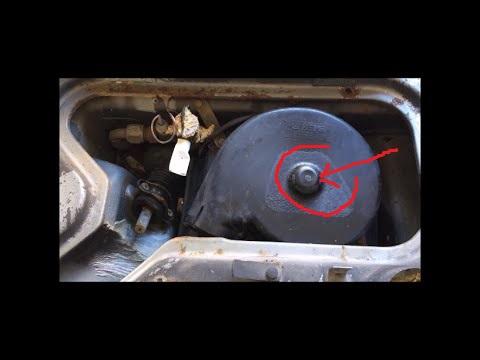

Anyone have steps or guidance for replacing evaporator motor assembly?
My evaporator fan is squealing and squeaking.
New one's here. Is it replaceable by a rookie?
https://tm2ds3p93zs2zbag83par8d1-wpengine.netdna-ssl.com/wp-content/uploads/91162490600-Porsche-Evaporator-Motor-Assembly.jpg
I tried searching but I didn't see any guides.

This is much easier with the entire evaporator housing out of the car. However, since you indicate your A/C is working, you don't have the option to remove it without de pressuring the system. So you'll just have to remove the top half of the housing, which contains the motor and blower. The hardest part will be getting the clips on and off. See thread below. Also make sure you are very careful with the delicate thermostat sensing tube when you remove the probe from the evaporator fins. You don't want to break it.

This thread has some interesting ideas on installing the clips. Hope it helps.
https://forums.pelicanparts.com/porsche-911-technical-forum/936421-question-theose-clips-c-evaporator-box.html

i used a little trick if the fan is noisy ...drill on top of the bearing 0.5mm hole and i use wurth HHS 2000 spray in and the noise is gone...works most of the time..
