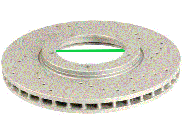

Need dimension from a 3.2 Carrera front rotor
Anyone have a 3.2 Carrera front rotor that can give me the diameter of the inner opening shown by the green line in this photo.
Thanks in advance!
Bill

107 mm
I think that diameter is the same since the 356 C, 912, 911. Not sure about the Turbos.

Bill,
are you still designing the 964 caliper upgrade ?

Thanks for that info!
Yes, I am still working on it, getting close to fitting everything up - I will be posting some pics and more info on the parts soon.

Those calipers will also work with a 298/28mm rotor (better).
