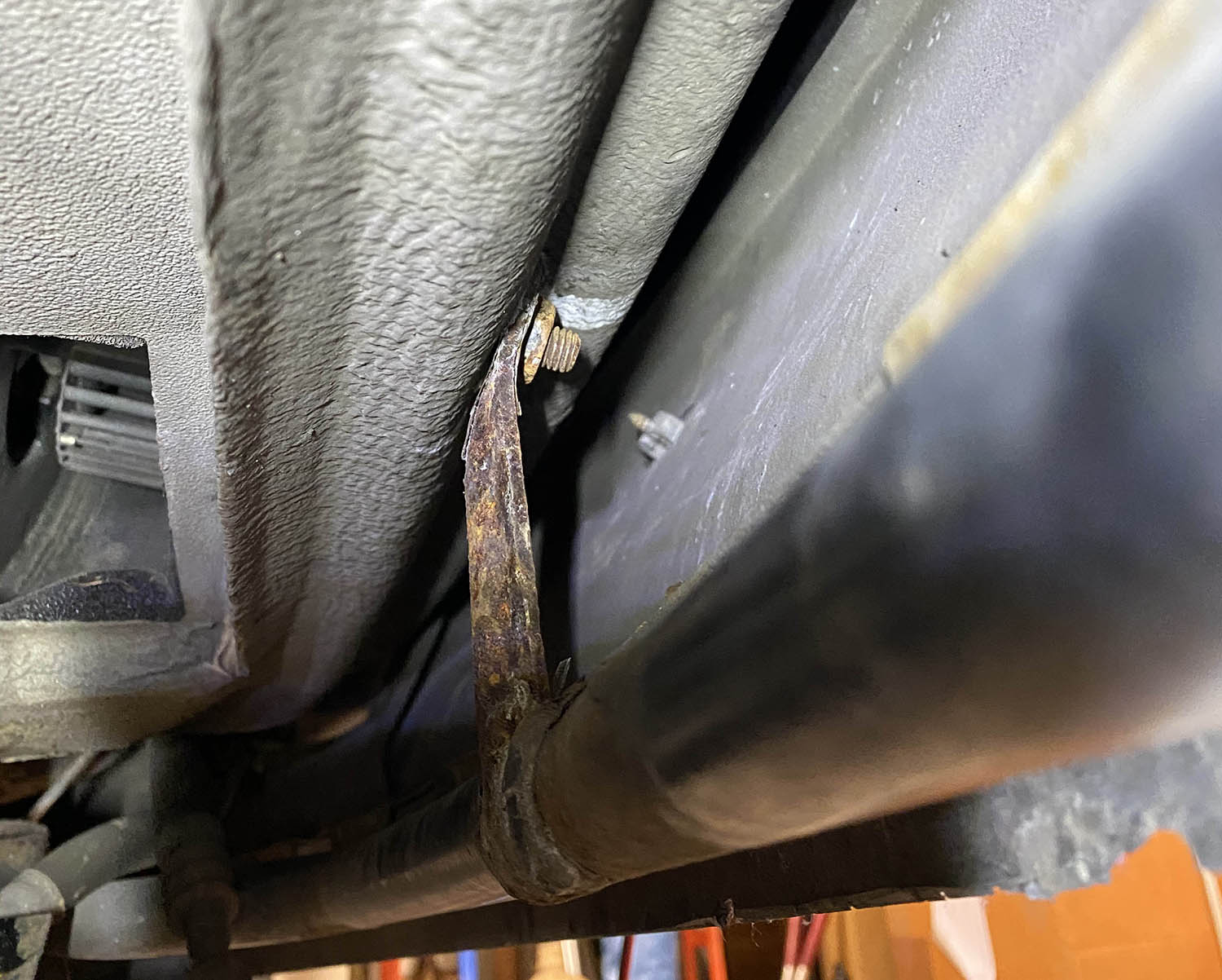

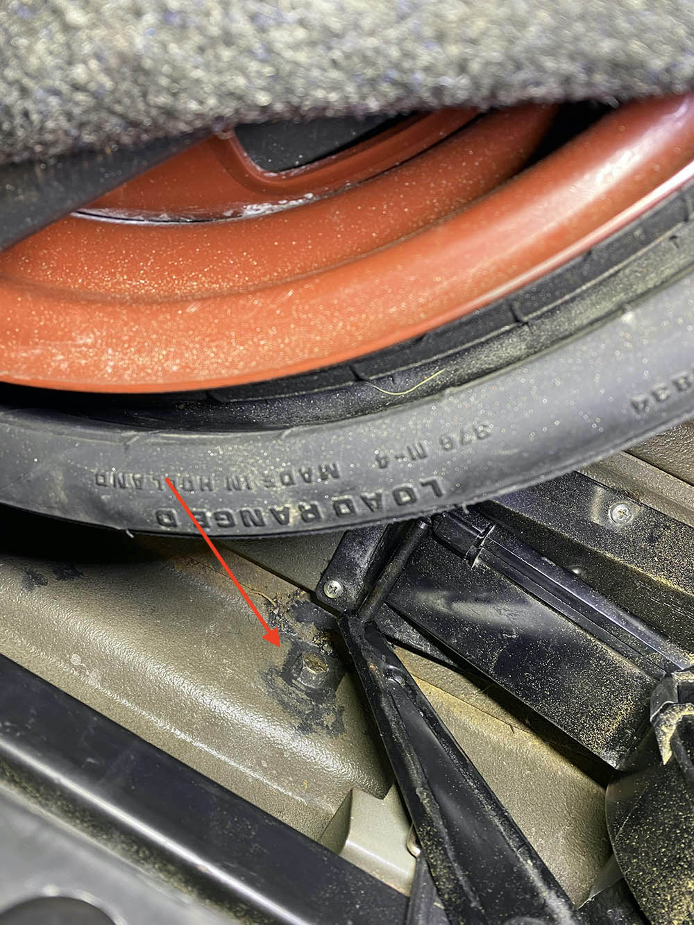

I'm trying to pull the protection bar from the front end of my 89 3.2. I can't seem to get a socket or wrench on the nut - looks like there's a bolt in the frunk, but I'm assuming the nut will just turn if I can't get anything on it. Do I need to grind down a wrench to get it to fit? Maybe the bar is bent which is preventing access? Any wisdom would be greatly appreciated. Thanks!
Here's a pic of the nut from the bottom of the car (protection bar as well)
And the frunk, which I assume is the bolt coming through:

The bolt in the trunk is what you take out. The one you show is the right one. The nit is welded to the bar at least on the ones I have.

Indeed, nut is fixed to the bar, just unbolt from the inside. Bolting it back into place is more time consuming...

Removing it to replace the control arm bushings, tie rods, ball joints, struts. Definitely will be putting it back on! Days of doing stupid crap like saving 5 lbs on a daily driver are far behind me fortunately lol! Going to hit it with some POR15 after sanding it down.
