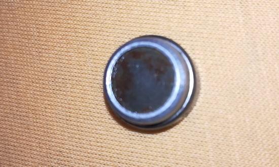

I would start with that ,to do that you have to go to pro Porsche shop or anybody who has a gas analyzer to set your fuel mix....this is the basics, before you start trouble shooting...
If that has not been done on your 911 you might have to remove AFM and remove the factory plug.Under there is a adjustment screw to correct the fuel mix...
look here
Also to set the correct fuel mix you have to measure before catalyst-if you have one on your 911...and oxygen sensor disconnected..which you can actually leave disconnected -i do not know how is in Finland with smog tests every 2 years?
look here
Oh ok i had never heard about this. Has it something to do with carbonmonoxide levels in the exhaust gases or why is it called CO adjustment? Why does it have to be adjusted now? Has the engine wear reached a point where it is necessary to get proper fuel to air ratio? Why do i have to drill the AFM? Is this an unofficial hack or is it in the factory maintenance manual? Sorry for so many questions but i am absolutely clueless and you seem to be an expert regarding 911 3.2's, absolutely golden information so far!
And my 911 does not have a catalyst or oxygen sensor so that makes the procedure a bit easier.

The plug you have to remove is Alu.plug not plastic.it is held in with a C clip on it`s end.The best how i do it is ,drill 2 little hole about 4mm between then use needle nose pliers and pull it out.Pretty safe stuff no worries.Once you have it check the fuel mix and adjust it,as it is on the manual instructions.
Still,if you want to duplicate the wet condition as i have suggested get a spray bottle with water and while the engine is running spray on each cyl..you see any miss right away...
Ivan
Oh ok still a plug though, seems simple enough. Maybe i should clean the AFM and throttle body while i'm at it? Seems like a good idea, and spray the water from under the car or..?

no spray the water on each cylinder on top to try to duplicate the wet weather.Not so much only little moist will find the crack or something in your system..the plug looks like this..when removed..bottom of it
Ok will test that the next time i get the engine running. Seems like there wasn't a plug in this particular afm(attached picture). Is the hole with the hex key bolt the right one? Also it seems to be impossible to open the afm for inspection, removed the sealant around the black plastic lid and tried to pry it open with a screwdriver with no luck. Any tips?

Wow that's my exact age haha, i've been around my 911 for 17 years but inherited it only 7 years ago when my father passed away.
Anyway i think i got the car working, didn't want to post this too soon, but after testing the car for 3 days the misfiring is indeed gone. Not sure did the cleaning of throttle body (which i didn't get a new rubber o ring by the way, the old one seemed ok though), AFM or IACV fix it.
Most probably it was the temporary high temp silicone sealant fix i did to the broken hose that goes to the throttle body. After that i had to adjust the motronic fuel quality switch back to position 0 from position 3 because the car was running lean and missfiring very badly. After the motronic adjustment 0 misfires, bit of backfiring after hard pulls though.
The vacuum line from the fuel pressure damper to the fuel pressure regulator was also disconnected from the fuel pressure regulator side (left side of the engine compartment) which could have maybe affected the engine? Noticed it while inspecting the vacuum line for fuel deposits which it didn't luckily have.
Thanks for all the feedback and help! Hopefully my joy isn't too premature. Will still get the CO mix adjusted shortly because it has been neglected for so long.

I wouldn't touch the mixture screw until you're sure your vacuum lines and everything else are up to snuff. Hoses that look cracked should be replaced. Switches should be checked for proper operation. IACV should be cleaned. Manifold boots checked for cracks. What I'm getting at is, make sure things are right before messing with that screw.
I'm going to disagree with proporsche on setting the base idle mixture being yearly maintenance. If your hoses are in good shape, your fuel pressure is right, your injectors are clean and your AFM is working properly, there shouldn't be a need to mess with that screw which is why it's capped in the first place. People pull the cap to mess with the mixture typically to overcome another issue with the car.
