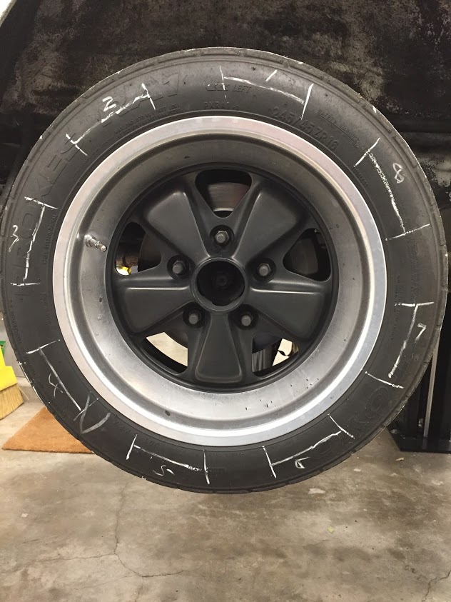

dap930 has it right, the sensor is a reed switch triggered by magnets in the transmission. A simple continuity test shows if the magnets are closing the reed switch.
The marks show where there was continuity when rotating the tire.
