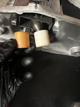

Spent some time replacing the throttle rod bushings and shift rod bushings since those like to disintegrate. I replaced the shifter ball cup bushing as well since I was already in there.

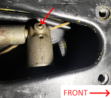

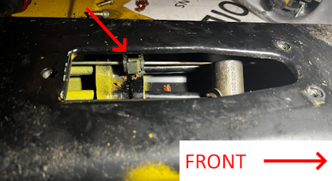

Throttle Rod Bushings, PN: 901-423-227-00. There are 3 of these inside the tunnel. The front is located underneath the shifter, the middle is located underneath the parking brake, and the rear is located underneath the rear tunnel cover. Front with the arrow indicates the direction towards the front of the car.
Front (Underneath Shifter)
Middle (Underneath Parking Brake)
Rear (Underneath Rear Tunnel Cover)
Shift Rod Bushing PN: 914-424-224-00. To access this bushing, remove the three bolts holding the shifter to the body and then remove the two bolts holding the shifter bushing bracket. After you have access inside the tunnel, remove the set screw that holds on the shift rod head.
Set screw that needs to be removed
Orientation of the shift rod bushing in the bushing bracket.
Shifter Ball Cup Bushing PN: 911-424-139-00. Very straight forward, pull the old one off and push the new one on.
