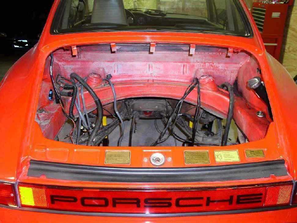

Since the front underhood area is mostly done, it was time to get at the clutch and a few other doo dads at the rear. This turned into repacking CV axles, brakes, bushings, trailing arm cleanup, oh, and refinishing the engine bay and detailing the engine. Even started replating parts, bolts, and brackets.
Here's the engine bay before:

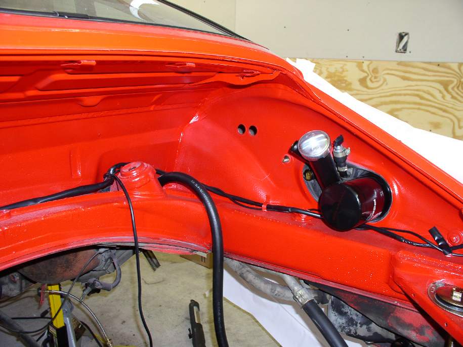

And after:
and another with some wire harness retaping...
Here's the engine...new injectors, spritzed up fuel rails, replated clamps, resprayed engine sheet metal, bead blasted intakes and anything else that comes off...

Looks great. Love the orange. The "while your in theres" are really worth while. The problem is not knowing were to stop!

Kah-rumba!!! Geez, it's easy to see what you guys do during the long winters in Minnesota. Unbelievable transformation to say the least. 500% improvement over the "before" pictures. You could write a "how to" primer on sprucing up your 911. Enjoying the updates and explanations behind what you have done.

the engine looks superb - is that the result of just bead blasting? or have you had the inlets etc painted? Are the fuel rails new or just recoated? is the gearbox just as clean?

rob justice-
The intake manifolds, throttle body, air vane box, ac bracket, etc. were cleaned up in a glass bead blasting cabinet at work. Its suprising how much crud comes off of them and how much they shine up. The trick will be to see how long it takes them to get dirty again (probably not long). I opted not to clear coat the stuff as I am weary of clear turning yellow and flaking off from the engine heat. I also took extra steps to make sure all of those little beads (like sand) are out of everything...
The fuel rails were bead blasted and resprayed with an enamel. Not real fuel resistant, but I didn't feel like cracking the hoses apart and replating the rails...if I messed up a hose it could easily be another $200 into this project...
Somebody along the line rebuilt the gearbox and did the gray spraypaint all over it. Looks o.k., it is clean now anyway.
