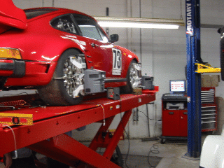

this is what I use to set the alignment on my cars
Though I do use strings lasers and levels when Im at the track, actually piano wireworks better than string. can be pulled taughter, and gives better resolution when reading the tape.
That big alignment machine isnt to portable
