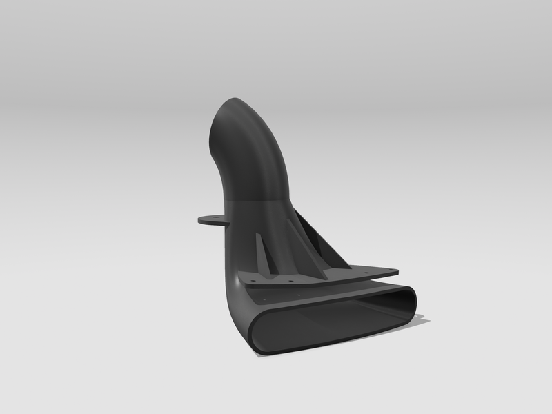

The options are:*
1.) drill holes/cut an opening in the bumper and fit it with mesh, etc... very hotrod and I suppose effective
2.) 3D print an air scoop to sit under the bottom edge of the bumper. Very clean and probably more effective but I worry about it being too low
3.) ?

I'm switching from an early bumper with holes in the lower valance to an S bumper without. I'm also going to higher compression, more aggressive pistons and cams and generally making the engine meaner. With the engine mounted cooler and the fan assisted fender cooler I never really had any trouble with cooling save for sitting in traffic on 90+ degree days but even still everything was under control.
That said, a friend with the same bumper does have cooling issues and I figured it would be a fun exercise to see if I could design something to assist with that.
This will be a little air scoop that mounts to the lower edge of the left side of the bumper and scoops*and shoves fresh air to the fan.
Initial CFD modeling shows that at 60mph the air will enter, slow down a bit along the edges to about 30mph but maintain 50mph in the center and then exit at 60+ mph due to the venturi effect. This little scoop- roughy 30cm x 160cm will capture about 3.5CFM at 60mph. Not a massive amount but better than nothing. I suppose the scoop could be bigger but at that point it's probably worth it to either add another cooler.
http://forums.pelicanparts.com/uploa...1763945823.jpg
http://forums.pelicanparts.com/uploa...1763945823.PNG
http://forums.pelicanparts.com/uploa...1763995645.jpg

Those ducts are great. What are you printing them out of?
For context on the cooling side + although I'm not running a mag-case 2.7: on a high-CR 3.2SS with an engine cooler + fender cooler + 7.5" SPAL fan I have _zero_ issues, even in NYC traffic on a 90deg day. 195F thermoswitch kicks the fan in sooner and the only real ducting I have is the little Achtung Kraft vent + the shroud/rock guard around the cooler to direct air to it. Even at 5k+ RPM for 10+ minutes and at altitude in NC with you I'd barely peak at 210-215F. It'd be back down to 200F within a minute or two of hitting traffic or cruising speeds.
I suspect you'll be fine with that duct/scoop. Plus it looks cool :-)
Showdown 11-24-2025 09:28 AM
This was a test fit out of basic PLA but the final will be out of PA6-GF/CF glass/carbon reinforced nylon; ABS. Should be plenty strong and resist temp/UV exposure I'll have to see how they look when the bumper is mounted- final shape is still open for changes.
Yeah, like I said, I don't think cooling will be an issue- in NC chasing you guys I was well above 5k for way longer than 10 mins- sometimes 6k+ and I was only at 225-230 and like you said, right back down to 200 once off the throttle.
