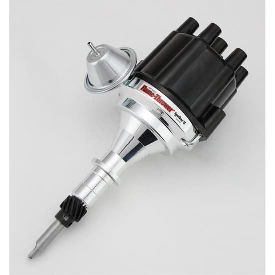

And depending on the level of offensiveness, there is most likely a magneto version (just for fun). HAHA And for more of a "stock-ish" look, use an original style (non-HEI) with Pertronix or the Pertronix distributor itself.
https://www.speedwaymotors.com/PerTronix-D106700-FlameThrower-Electronic-Distributor-L6-GM-BlK,300331.html
Stock points style
https://www.motorcityreman.com/dst1612.html?cmp=googleproducts&kw=dst1612&gclid=EAIaIQobChMI4ZSmwvD4-AIVWcvICh0zXAf0EAQYAyABEgLUX_D_BwE
Nice work, man!
