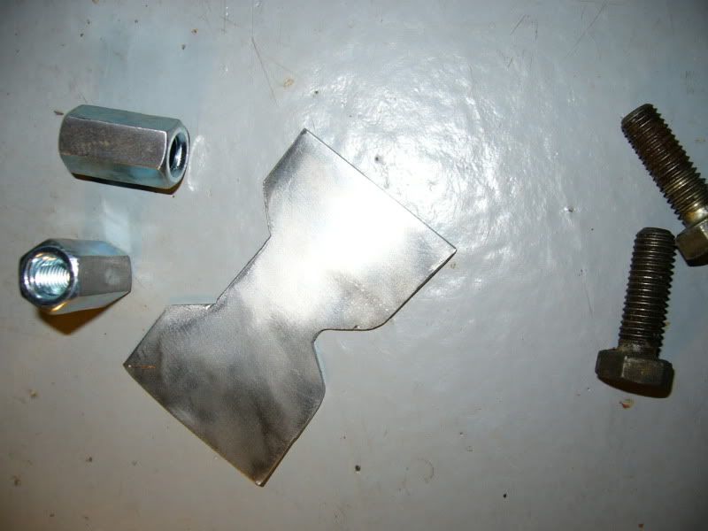

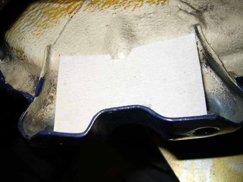

I just did this as a "preventative upgrade" while my motor was out. This idea was stolen from someone else, I just copied!
Anyway, I used 16 Ga sheet metal to make a plate that would fit in the perimeter of the backside of the the mount. I used a cardboard template to get the size and them simply cut the sheet metal:

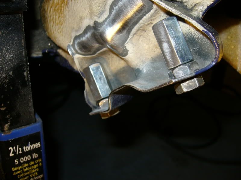

Along with the sheet metal plate, I used a pair of M8x1.25 coupling nuts per side. This protects against that "other" sway bar mount failure mode... stripped threads:
After sanding off the zinc plate in the areas to be welded, I then mounted the coupling nuts "in series" with the existing threads:

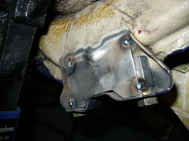

Added in the sheet metal plate and tacked it together:
And then welded it up securely:
Next is just primer, seam sealer, body schutz etc. to proprely protect everything.

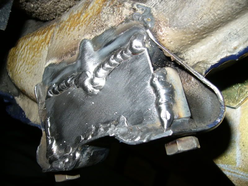

Here's mine...
I used thin steel plate to create a 'butterfly' to try to triagulate the mount. Welded it up - new paint and a later Carrera bar. No breakie yet.
Here you can see my mad welding skills...
