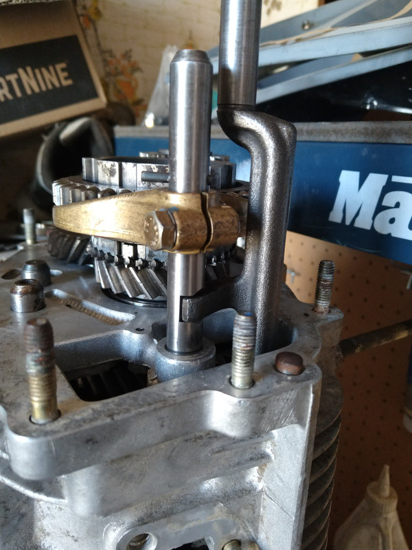

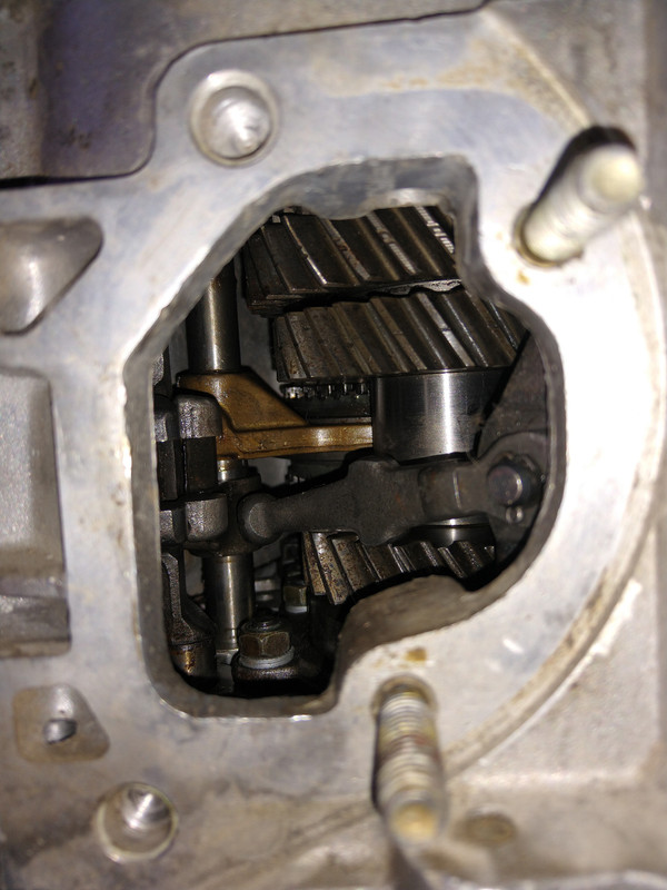

blur911 04-16-2023 07:03 AM
Originally Posted by Walt Fricke (Post 11974405)
This is all easier to understand if one has had the nose piece off at some point and seen how things work in there. I couldn't find a picture in my collection of that.
Didn't take John but a millisecond to guess what may have happened and how to fix it. I tend to get carried away with the "why."
Hi Walt. I have the nose piece off one, waiting for a new staked nut. Anyhow, here are a couple of photos illustrating what you said. The shift rod is engaged in the reverse/5th notch.
https://i.postimg.cc/VsZPXc8g/IMG_20..._095634901.jpg
https://i.postimg.cc/gkwFDBcW/IMG_20..._095800732.jpg
