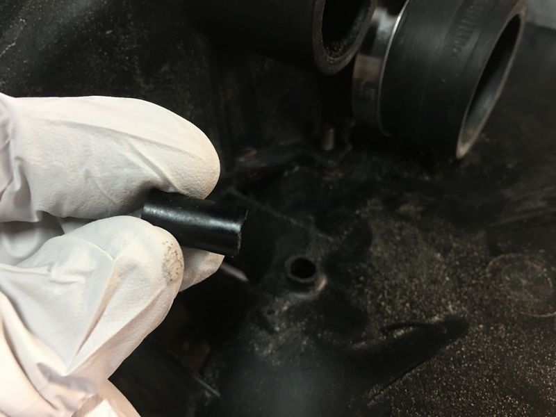

Trying to put the CIS back into the car yesterday
(it was not a good day, the CIS is back on the workbench)
I broke the drain tube mount and the WUR nylon feed line.
Here are some pics:
The test fit (that used to be a SS drinking straw. I thought "oh that is waiting to poke my eye out" so part of it is being used to fix my airbox)
And after applying some JB Weld (I hope whoever invented that stuff made millions and lived happily ever after...)
Yesterday I realized, yes you CAN take the CIS out of the car while the engine is still in.
But you can't put it back (you can't tighten the #5 and 6 intake runners with the box in the car)
So the engine is coming out anyway.
If I had done that in the first place I could EASILY replaced my leaking fuel line, without dis-assembling the entire CIS system.
I am going to do a seperate post on that experience (disaster?) when I have time,
right now, I need to learn how to repair broken plastic CIS lines...
