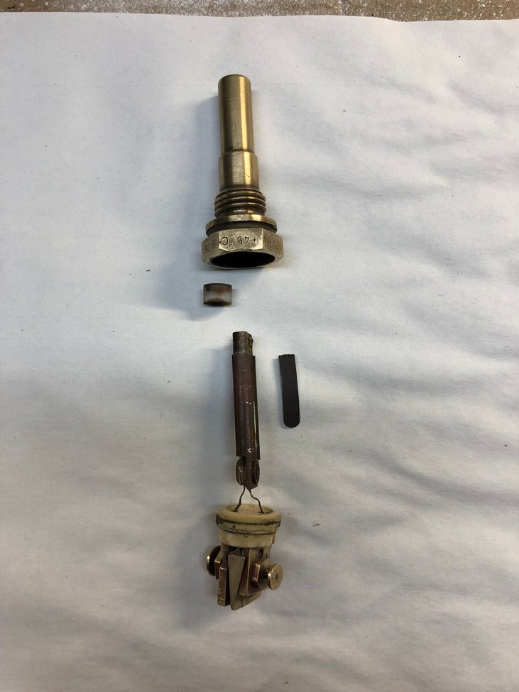

acorad 10-16-2024 08:25 AM
Having gone through removing the CSV on my 1978SC I can give a tip on removing it. After several false starts I found the easiest way was to remove the heater ventilator and all the brackets in that area supporting cables and fuel hoses, particularly the one that partially covers the CSV. I had a cloth at the back in case I dropped anything and used a mirror to see what I was doing.
Roy
_
Thanks Roy, that is very helpful.
acorad 10-16-2024 08:42 AM
the resistance table to test the TTS is applicable the old electromechanic version of the TTS! The fully electronic version cannot tested in that way! It requires a bench test being wired & powered as it is in the car too. Unfortunately I cannot tell how to differ between both versions.
Thomas
Thanks Thomas, we bought the car around 2012, the TTS that I tested was in there when we bought it. I think it is old-style electromechanical, it looks like the TTS in the first photo below.
The second photo below is the new TTS that I ordered from Pelican, it looks quite different from the old TTS that's in my car.
My old TTS looks like this photo (except it's not cut apart)
https://cimg5.ibsrv.net/gimg/rennlis...390e7c884.jpeg
Photo of new TTS that I ordered from Pelican, photo is from Pelican website.
https://cdn1.pelicanparts.com/catalo...117-01-OEM.jpg
