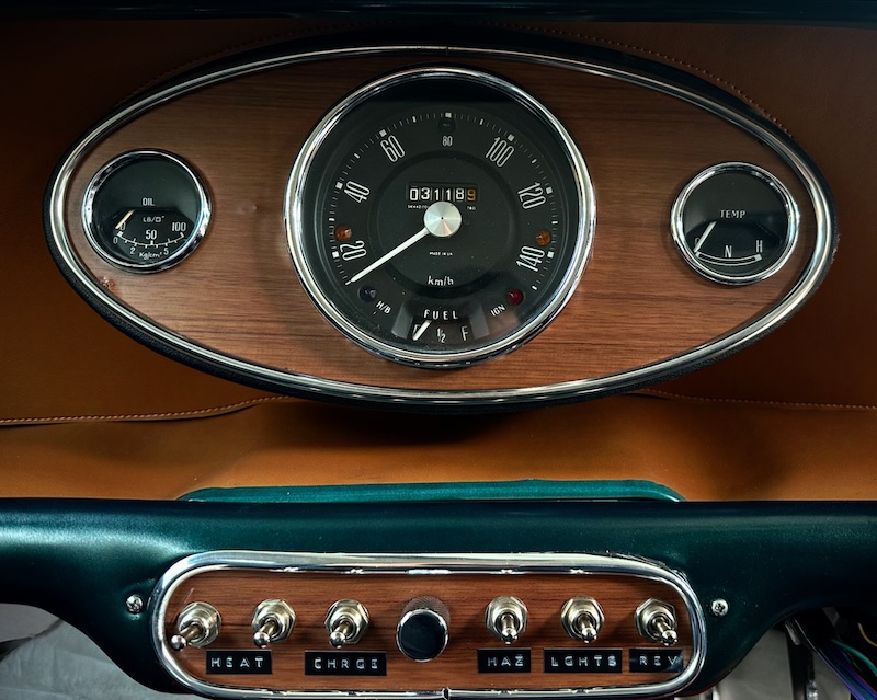

Having a phone mounted in my vintage car kills me. An option I'm considering for the 911 is the NVX XUBT3. You can easily remove the knob and install most other knobs without issue.
If you measure right, you can put the whole face behind the mounting panel so you can't see any of the lights.
I put a guitar knob on one to match my Mini (center), but I was gonna use an original fog light knob or some such for the 911. My car doesn't have fog lights, so I can use the place where the knob usually is...Another option is a stereo blanking plate with a hole drilled in the center...Still leaves room to put a little amp back there if you don't have room under your seat:
https://ensaster.com/pics/vehicles/m...sh-labeled.jpg
I also had one in a Smart ForTwo ED that I face-mounted (after spray-painting black) to an ABS/HPDE plastic panel with a Vox amplifier chickenhead knob:
https://ensaster.com/pics/vehicles/s...iever-knob.jpg
