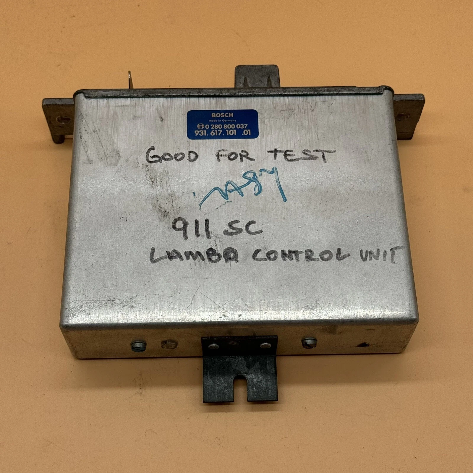

Originally Posted by MD540iT View Post
Hey guys, So again here working on my 924 turbo CIS, and since theres a lot more activity here, hoping you all can provide some insight. has the same "TPS" as 911 SC with the 3 positions]
The SC models 80 - 83 came both with a 2 position TPS.
1980 --> one at idle and one at acceleration (35°)
1981-83 --> one at 15°/mid load and one at acceleration (35°) (with this type an additional microswitch indicates the idling state)
ok well any idea on how to adjust whatever it making it go very rich "off idle"??

As this switch is part of the electronic motor management of your 924, you should let check the ECU first.
I guess i could see that if you dont consider the "idle switch" a position
If idle is set to closed throttle, I dont know how else to adjust??
Apparently this is also used in the 965.
Not sure how to play with the ECU here, this CIS is so antiquated. I see why people swap to carbs.

technically seen, "idle" is a position on the TPS.
You should not play with the ECU, you should let a service check it for you.

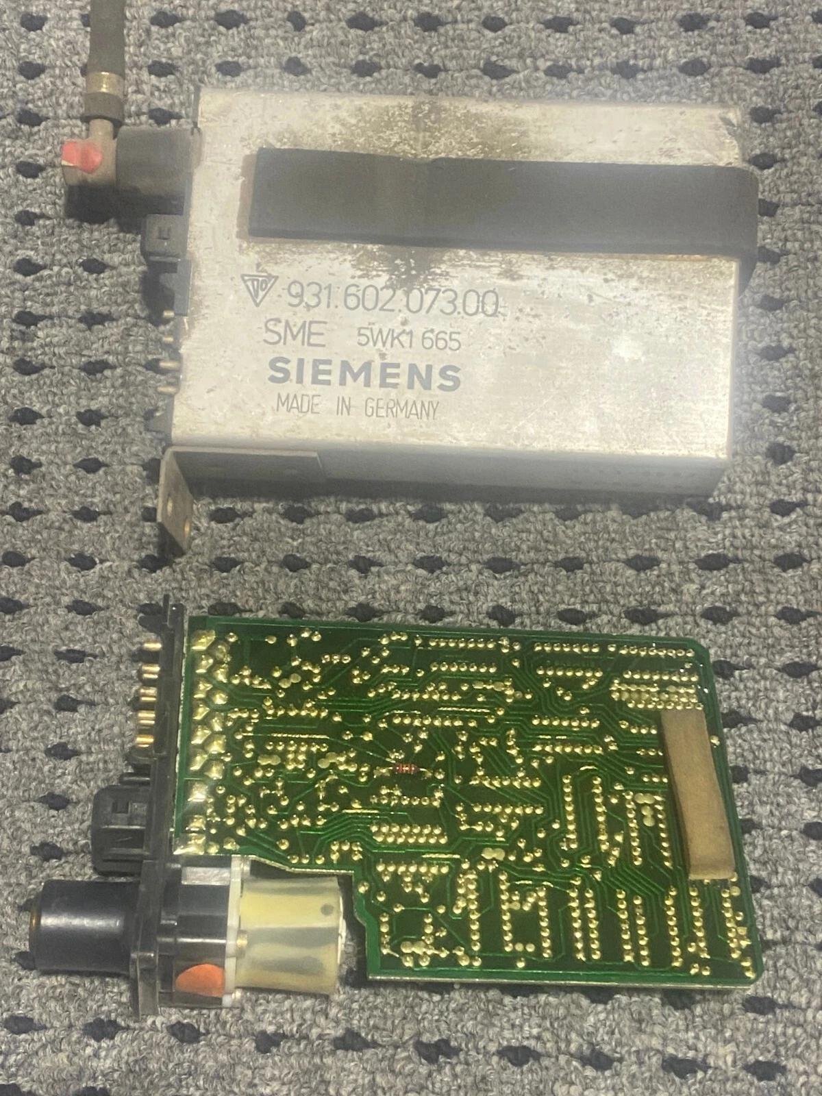

Originally Posted by wazzz View Post
Was the ECU specific to US models of 924 Turbo? I've owned two of these cars. Both were 1979 RoW models and I entirely stripped one of them after it was totaled. I can't remember of any ECU in these cars. As far as I remember they used a very basic CIS system with no electronics except the CDI.
theres an early79/80 and late 931 81/82, the early one is "transistorized" and the later is "digital" (like a casio watch!)
I really need to get on the EFI conversion, just wanted to have it drive-able while I assembled all the pieces
heres what is in a "S2", second one is the "boost module" Like a KLR in the 944T
