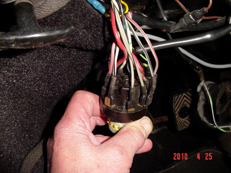

It's a new wire harness from Restoration Design for my car. I have been talking to the tech guy at RD but we are yet to figure out what's going on. I think it's my connections at the back of the light or hazard. Let me take a few pictures and post them. I do have wiring diagrams but not for the back of the light switch

Here are pics of my wiring behind the lights

and pics of the Hazard switch wiring

E Sully's Avatar
Join Date: Nov 2008
Posts: 3,963
Some of the main problems come from improper grounds. Make sure the ground wires in the front fenders are clean, and the rear tail light housings.
The connections at the parking brake handle can be a bit difficult. I don't have any good pictures of that. On thing to look at while your in there is to make sure the hand throttle linkage is in good shape.

Here is how I hooked up the lights. Yellow post-it notes are my connections. I found this illustration online.

Your light switch looks right.
