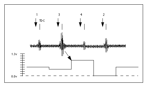

John at J&S 05-15-2006 02:42 AM
Originally posted by ivallt
...I use J&S Safeguard for my knock control. I have talked with the owner extensively and if a few people are interested, i could probably get a discount. I dont care much for the J&S gauge so i am hooking it up to a wideband controler by PLX devices (the R-500).
If the PLX has a spare channel, you can log the knock/retard monitor output of your J&S unit:
This drawing shows a typical knock trace with three knocking cylinders, and the correspoding output from the monitor jack with the SafeGuard set for individual cylinder retard.
The down arrows correspond to ignition triggers. Note that the retard voltage for the present cylinder does not become valid until after the knock event, and remains until the knock signal for the next cylinder is processed. This voltage represents the amount of retard that the present cylinder will experience, the NEXT time it fires.
If you were watching our knock retard gauge, it would appear to have three LED's lit at once, since the retina of the eye has persistance. In reality, the signal turns on the fourth LED, then the third, then the seventh, then none, and repeats, until the value for each cylinder is changed.
If the unit were set to retard all mode, the output would be a flat line at the level commanded by the cylinder knocking the most.
http://www.jandssafeguard.com/MonitorVoltage.gif
3.5mm STEREO plug
Tip supplies 12v to power the gauge
Retard signal is on the Ring
Sleeve is ground
http://www.jandssafeguard.com/images/PStereo.jpg
