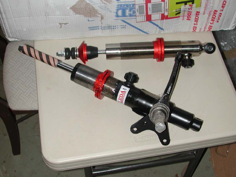

Leda. Nice, easy to reach knob.

The Ledas are great, but they're pretty old-school. I have the cheapest ones they sell, which cost about the same as Bilstein RSRs, ~$1500 all around. For me, it was only a couple of hundred more than doing a four-corners standard Bilstein conversion, so the adjustability and down-the-road coilover potential was a nice bonus. The best part about Leda is that strut length and spindle height are no-cost options, so you don't end up with a standard length Bilstein or Koni which may not be ideal for your ride height.
For track junkies, Leda does remote reservoir, double and triple adjustable units for several $k.
I read the Excellence article, too, and I recall that there was going to be a less expensive version from Smart Racing also. Might make sense to wait and see what they come up with.

Chuck, on mine, the adjustment changes both bump and rebound, but in fixed proportion with a single knob.
